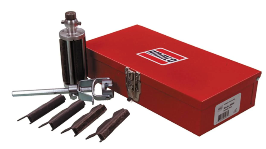

I bored 2 cylinders last night. Took it slow, ended up doing about 5 passes for each cylinder. My Ammco hone, at 2.5" (63.5mm) is just barely small enough to do these cylinders.

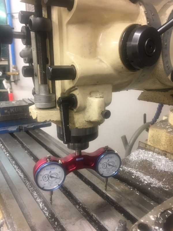

Tramming the mill in preparation for boring...

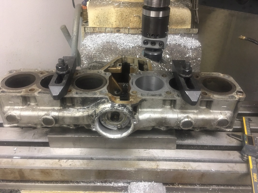

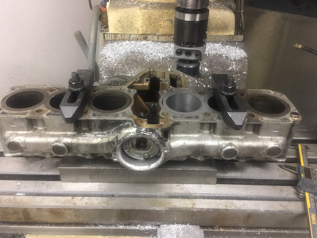

Boring in progress

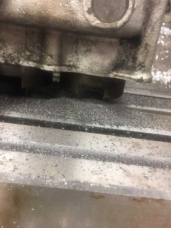

When folks talk about machining something to go over the liner, they are talking about this potion that sticks out below the cylinders. That liner support would ONLY be used during the boring/honing operations. The case supports this part of the liner once assembled. I chose not to make the support and just limited how much material I removed each pass. As this portion is an interrupted cut it is important everything is rigid.

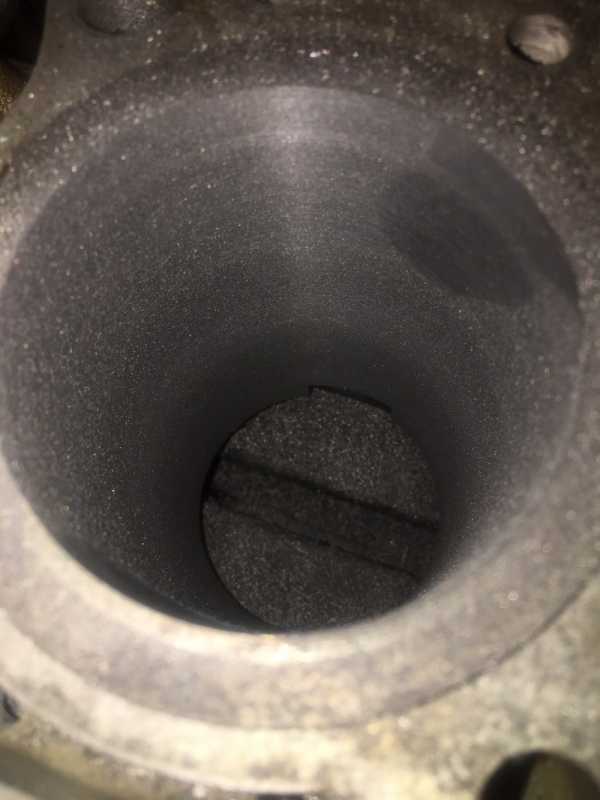

A freshly bored cylinder (not honed).

On the hone... I have an Ammco Rigid. I don't think you can buy these any more. Mine is 3/4 of the way to being an antique. Much like my ring filler - with all the cheap tools these days, a lot of well made stuff is simply out of production. Sometimes it is better to buy a lightly used 30 year old tool. But the Ammco rigid hone is effectively the same as the Sunnen rigid portable hones. New stones are still available for the Ammco. Mine is in a green box and I have fine/med/coarse stones. But otherwise, looks like this:

The hone I had in my workshop was a Lisle 15000. Still well supported for stones. 4 expanding stones that all move in or out synchronously through a central gear drive. With a bit of practice, you can achieve a true round bore within .0002". If you wanted to true up a bore or go to the next oversize and it's less than .010" bore difference, you could just use the Lisle hone. More than .010 and you really need to bore true to within .003" - .004" and then hone.

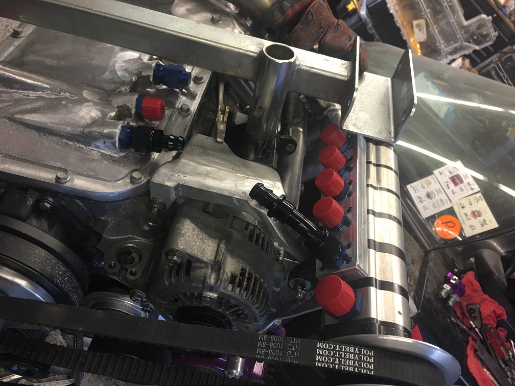

So now it's back to squeezing this dry sump setup into the car. I did cast the oil pan in the picture in my back yard! May cast my own design KZ1400 emblems for the bike.
