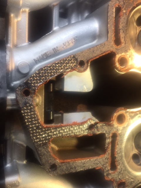

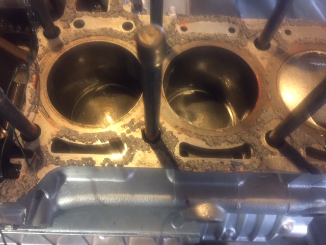

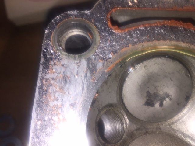

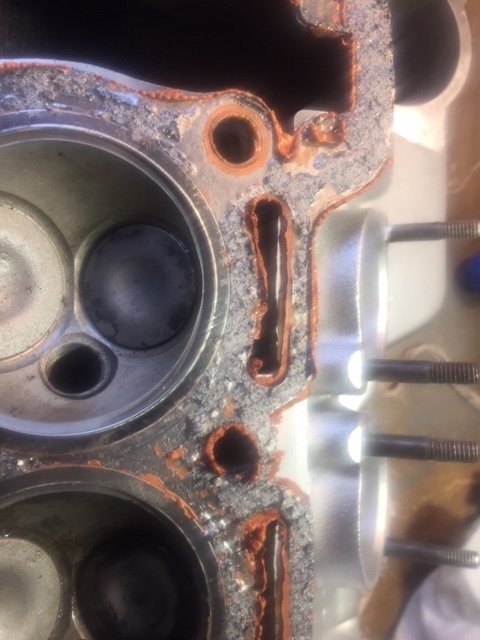

Well, I took a sharp intake on breath and took the head off again.
Two lessons learnt:

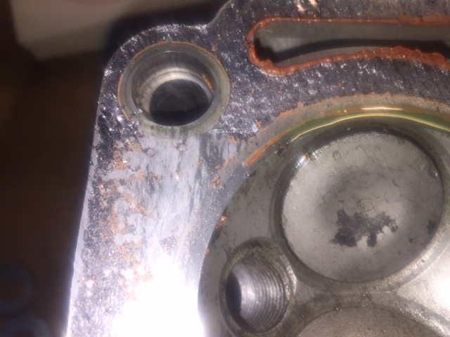

1) no need for liquid gasket when using a proper head gasket as it comes with its own 'soft coat', you can see from the pics that the extra (very thin!) layer of liquid gasket (in red) just squeezed everywhere it should not have gone

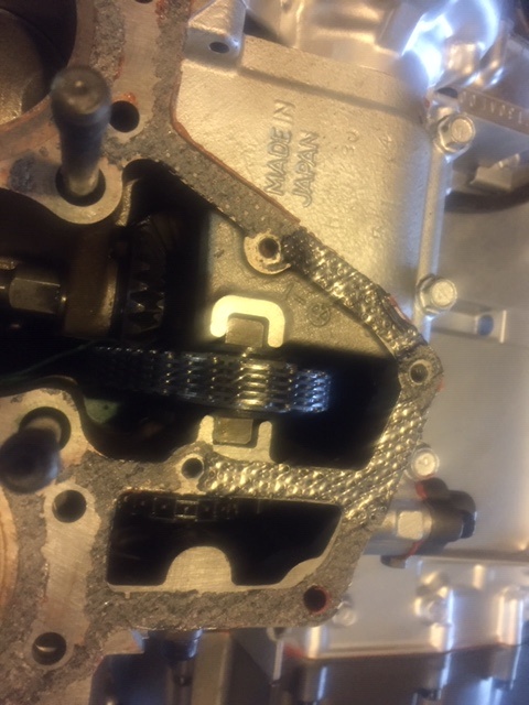

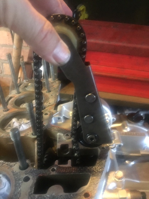

2) there is a proper way to insert the cam chain into the tensioner holder... please do not do what I do and just drop it in, the chain needs to wrap around the wheels in an S-shaped fashion.
I now have to clean off the old head gasket and liquid gasket without any of the debris falling into the motor or the waterways - what a nightmare - and get myself a new head gasket!

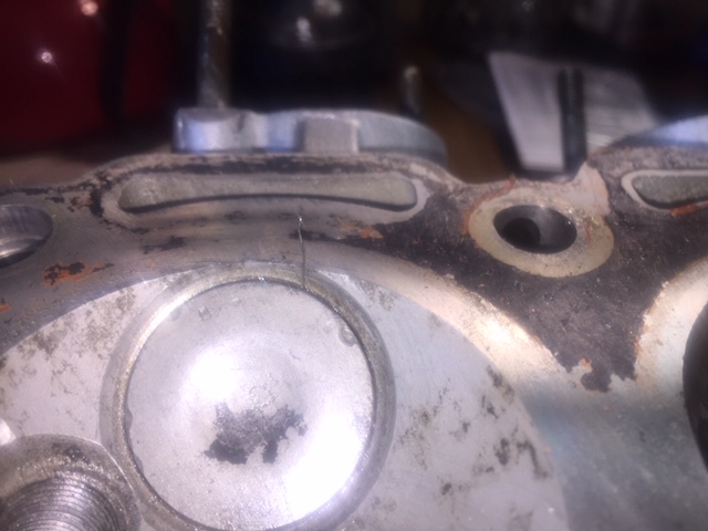

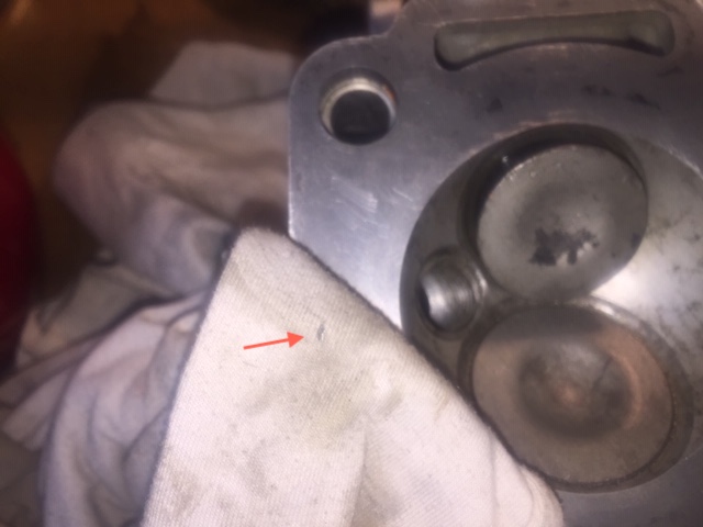

One lucky find: when cleaning the head my finger caught on a small piece of metal wire that was stuck in one of the valves. If I had not screwed up with the cam chain tensioner holder, that would have fallen into the cylinder and buggered everything up properly! :S Lucky escape!
When fiddling with it, it broke off, so I had to open the valve and retrieve the bit still in there, you can just see it on the cloth.
Now I am cleaning everything again and once I have the new head gasket I'll carry on.

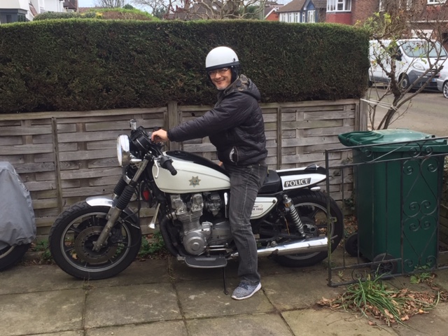

In the meantime, Koba (from Japan, we met on this forum) came for tea, a view of the project and took a ride on my KZ1000P. Think he enjoyed it!
That's a good story with a happy ending and complications avoided Paul. You could call it an example of a blessing in disguise.
I will reflect because I remember exactly the moment we were discussing the gaskets. It was about applying some liquid gasket to one side of the cylinder block gasket (bottom), and then your next post was with the head already on! I thought - that's fast! You mentioned something about applying a thin layer to both sides of the head gasket. I thought - ah.. too late! haha I remember just hoping it's a very, very thin layer, maybe only around the water passages. Now I see it was quite more, and it got squeezed and pushed into the undesirable areas. One, undesirable around the combustion chamber. Two, it went inside the water passages. I am sure it would pollute them eventually for sure, perhaps causing sealing issues around the water pump, maybe got stuck inside the thermostat. The piece of wire - actually I think it would get blown out as soon as you'd crank the engine. I think your engine would be fine if you left it as is and the bits of silicone, if broken off, would come out after flushing a couple times down the road would you experience any problems.
Just to reiterate, the stock head gasket already has a very very thin coating of solid silicone, and there is extra solid line around the water passages. That's different from liquid gasket - these stay in place and don't get squeezed out. No need for anything extra with stock gasket. Different story when using some aftermarket gaskets, or damaged gaskets. People used thin lines of silicone around the water passages on those with good results.
I think lesson three would be to double or triple check everything, especially in an unfamiliar environment. I admit I have a tendency to unnecessarily rush through things myself, and still learning to take a deep breath sometimes! haha We are not in a field at war, haha, no need to make quick decisions. Although I know you had a deadline

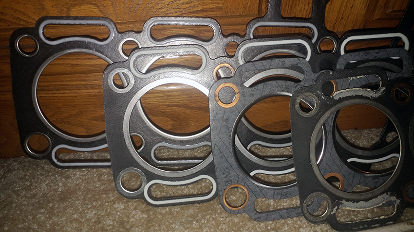

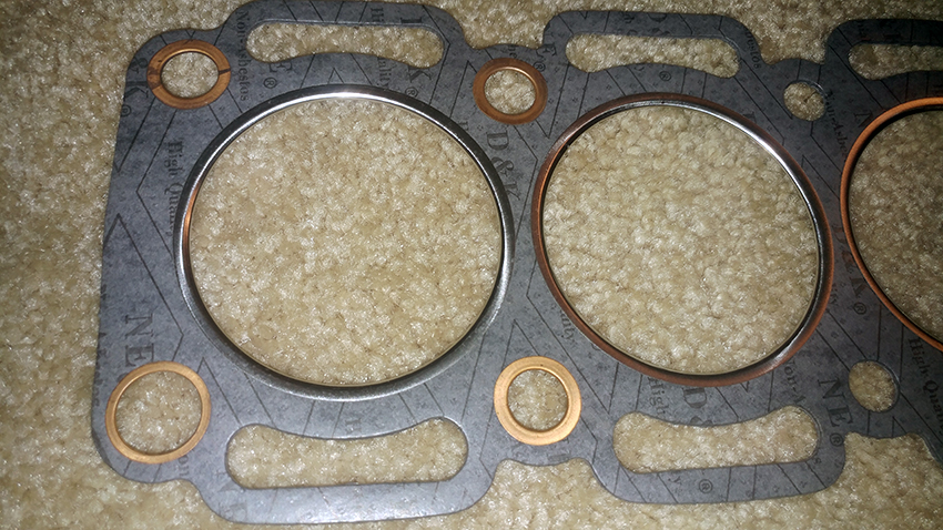

Stock Kawasaki gasket with damaged silicon (brittle). This one is from eBay. One that I bought from Kawasaki dealership, although expensive, was perfect.
Aftermarket head gasket without any silicone.
I think the smile on Koba's face says it all!

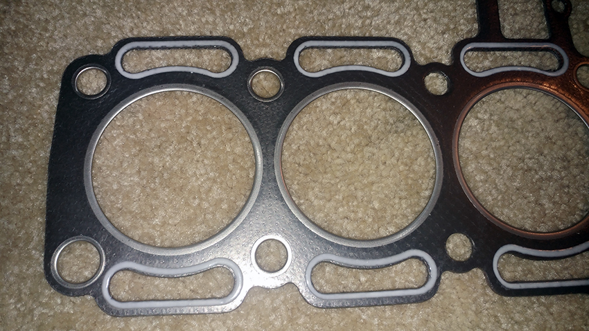

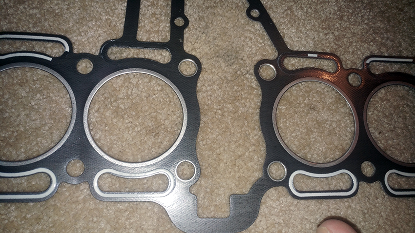

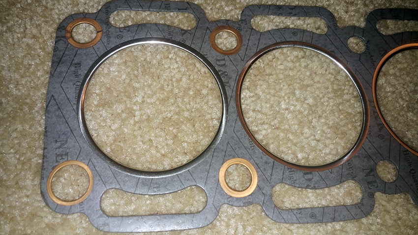

Just for the record, to have things in one place..
This is how stock Kawasaki head gasket looks (fresh and ready):

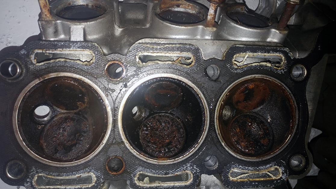

This how it looks after removing (after sitting with flooded rusting cylinders for 20+ years):
Last edit: 7 years 10 months ago by StanG.
From left:
From what I gather, if using aftermarket or 'sour' stock gaskets, apply thin line of high temperature silicone and let it sit to dry. That will mimic a good stock gasket and will not get squeezed out like in it's semi-liquid state when freshly applied.
- OEM Kawasaki current stock from dealership
- OEM Kawasaki old stock from eBay; damaged silicone peels off and chips; discoloration due to hardening over time and bad storage, see above for nice fresh
- aftermarket from eBay; common style
- OEM Kawasaki removed from my bike; 1982
