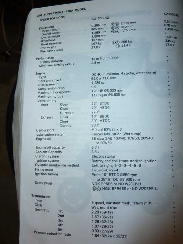

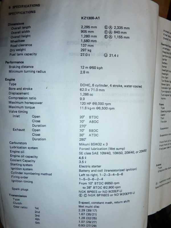

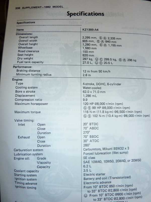

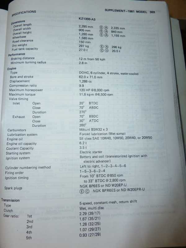

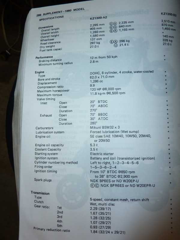

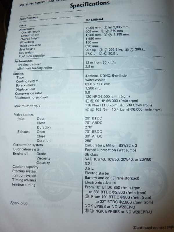

Checked one of my manuals. There does appear to be 3 different oil volumes for engines[/attachment]
listed.
If there is only two different oil pan volumes , and all clutch covers are the same size, then how is there 3 oil volumes.
