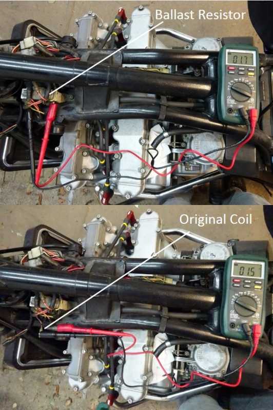

I decided to measure my old coils and they measured 1.7 ohms. Even the one coil that was split down the middle gave the same reading. Kawasaki say that a multi meter is not the definitive way to check the condition of the coils as a multi meter will not show if the insulation is breaking down. Anyway, I took a second reading with the Kawasaki ballast resistor in line and all three coils are coming in around 3.7 Ohms.

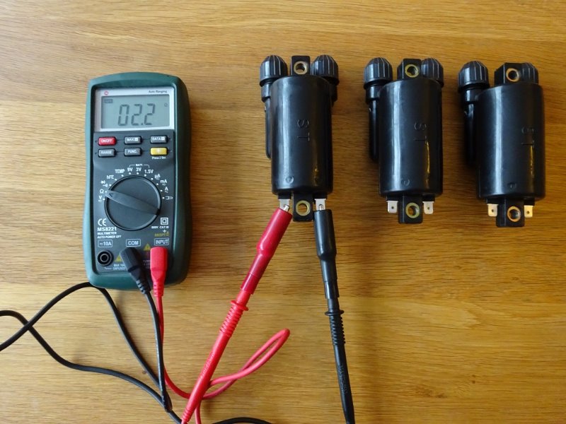

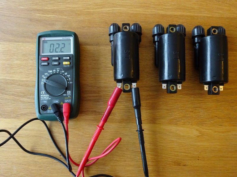

StanG, regarding mounting, I purchase coils from MCG which had the same mounting arrangements and holes in the coil laminations as the originals so I just transferred the original fixings to the new coils. The brass tubes are only there as spacers - they would fit a smaller diameter bolt if necessary without any problems - the standard bolts are a tight fit in the frame mountings so a slightly smaller fixing bolt might be an advantage.
Regarding this controversial topic of resistance, I would suggest that there is an acceptable "range" of resistance where the ignition system will work well. The minimum seems to be about 2.6-2.7 ohm and no-one really seems to want to go above about 3.2 ohm. I personally would recommend that you use the same ballast resistance for each coil. I am not sure it is critical whether you go for 0.4 or 0.5 ohm resistors - I would probably chose on price or quality.
I measured my original ballast resistor and coils and they were both very close to the nominal spec quoted in the manual (see pic)
My new coils were measured using the same meter and came out a 2.2 ohms - all the same.

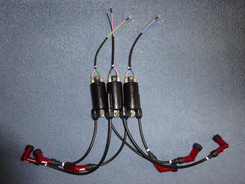

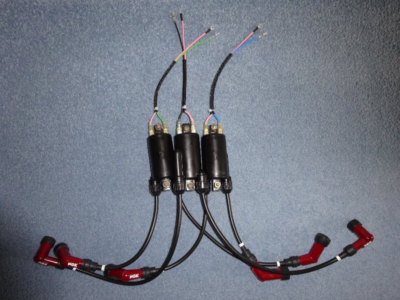

I wired them up using wires as close to the original colours as possible and all 20 amp rating. Just added some heat insulation to the lead wires as well.

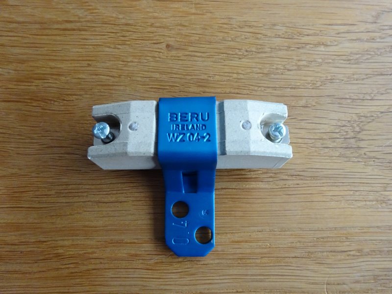

This were the original Beru resistors - important to remove the original mounting bracket carefully as the ceramic resistors are brittle
