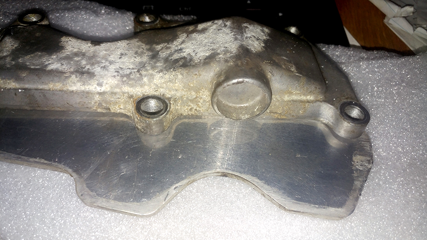

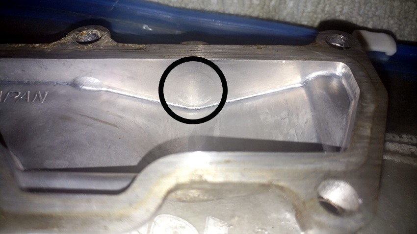

A little 'interesting' riddle for scotch. What is this? Of course I do know! haha

Well it's obviously some kind of cooking utensil because it clearly says "Pan". Fancy Poached eggs !:woohoo:
Or, could be a reed-valve lid from the cam cover.
Lets see how many more names we can come up with for our various parts. You know - for clarity :evil:

Nice job blocking off that 13mm hole in the cover. I had to pull up a picture of the cover from a previous post to see what was suppose to be in the " roof of the cover" and.....
What did you use? The aluminum solder that melts at 600 F ?

Here another shot of the cover and a plate it came with. Something new to me and puts a twist on the whole removing of the reed valves, plugging the holes and getting rid of the afterburner emission control air vacuum valve.
