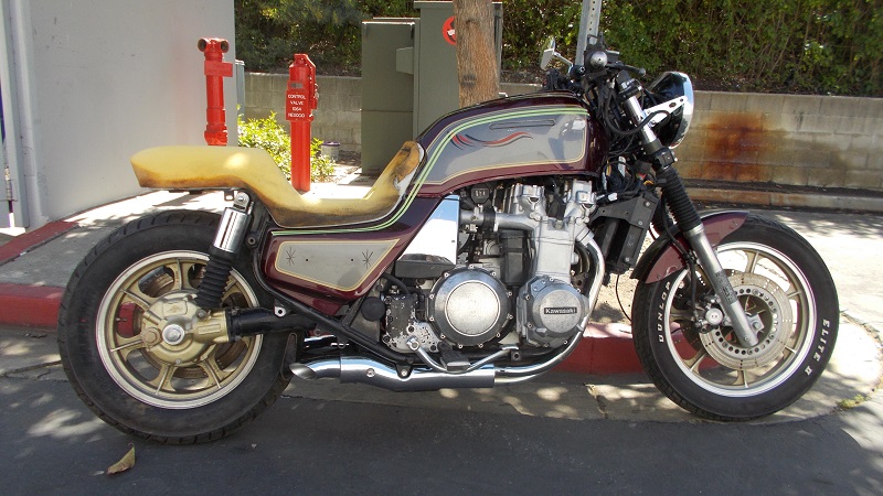

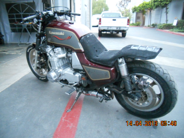

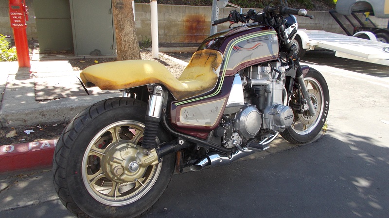

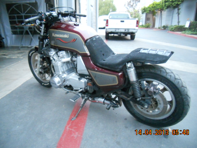

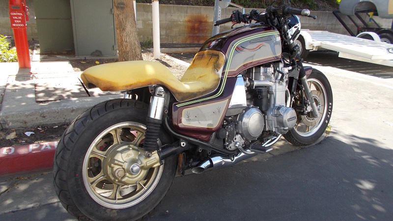

this is an 1986 voyager that I bought and stripped down to what I think looks good...

Interesting exhaust system. What make is it? I don't think I've seen it before. I like the lines between the side covers and the tank. Nice transition.

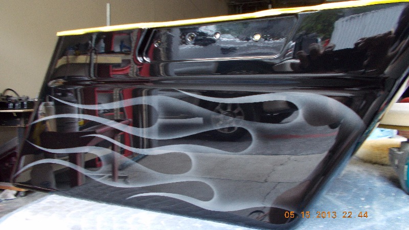

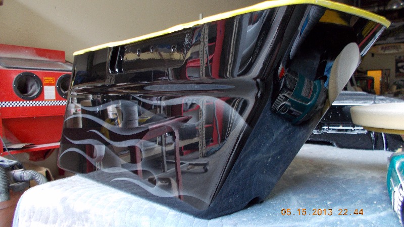

that is the stock voyager exhaust, I pulled the mufflers and put those tips from autozone on there.. looks pretty cool does'nt ..the transition lines are pinstripping tape.. when I paint the bike I am going to base coat in gold metallic and then add those tape lines and then over the top of everything with a jade green mettalic, then pull the tape and clear to bury the gold lines. just how I did these ghost flames on this harley bagger...
