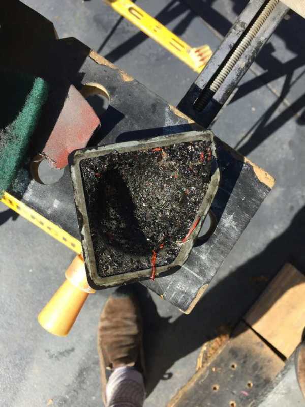

Well i thought i was on the final push to get my bike on the road but the bike has other i dears.Pulled tappet cover off and checked valve clearances and the nice person before me has ground no 1 inlet shim to get some clearance :evil: So Ive had no choice but to pull the head Ive also pulled the water pump cover off and the is some free movement in the impeller i can rock it clockwise and anticlockwise looking at the manual it is driven off a cut out on the back side of the impeller how much movement should there be i am just about to shove the bike in the corner off the shed and forget about it for a while with the purchase of it and repairs i am up over $20000 NZ DOLLARS

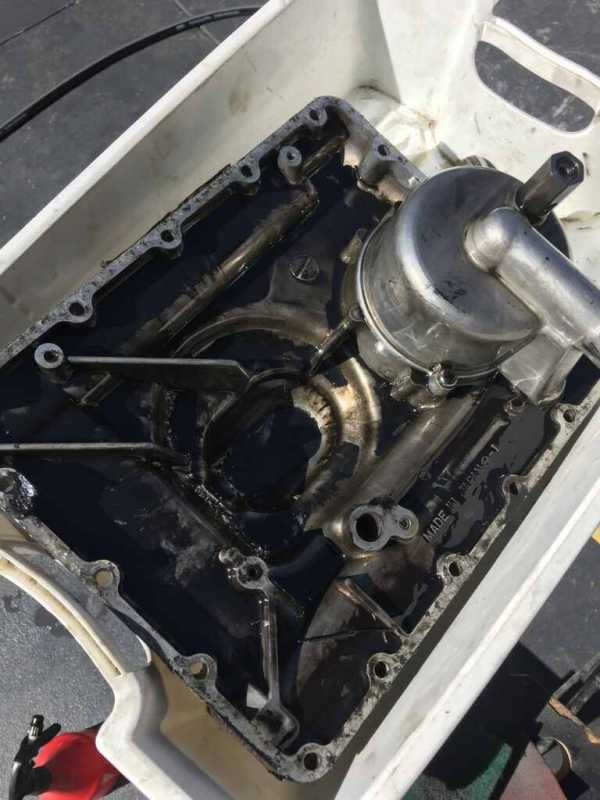

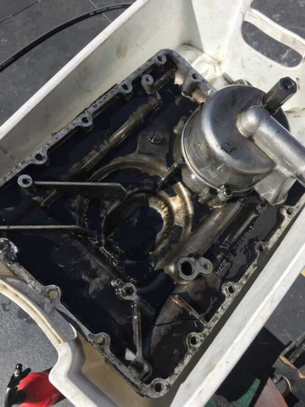

thanks for the reply i also pulled the oil pan and checked the oil pick up it was Nealy totally blocked with silicon ill post pictures i only brought this bike because the bike shop in Scotland said it was the best he had ridden said he had owned 6 z1300s and it was been ridden daily i am gutted and Ive been ripped off :evil: Thanks to you guys making more parts ill get it back on the road i need to order timing chain inlet valves and ill replace the plastic idler just to be safe
thanks Graham
