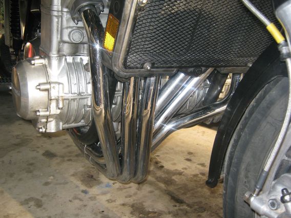

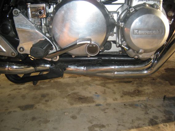

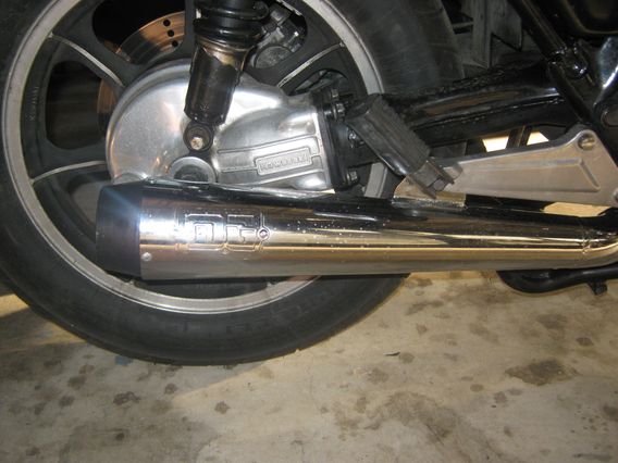

Did the valve seals plus put a new set of pipes on, pretty and shiney

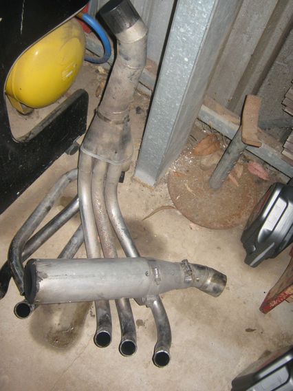

Old pipes heaps of holes

Hi Pete,
Those DG's are pretty.
I just finished rejetting my 1300 to match a set of DG Six into One's. Let me know how it goes for you.

Tx for posting. My 79A1 has a set of DG 6into1's waiting the motor rebuild. Good to see what the final product looks like.

dcarver220b wrote: Tx for posting. My 79A1 has a set of DG 6into1's waiting the motor rebuild. Good to see what the final product looks like.
Slight problem with the pipes, seems pipe from number 3 is a tad short when the muffler is mounted on the rear foot peg bolt, had to slot the hole (ended up with a slot all the way to the end of the tab) so I could move the muffler / collector box forward a bit so all the pipes went in a bit more to stop exhaust leakage, there is still a small amount of exhaust leakage but that can be fixed, apart from that they sound great, cheers
P.S. don't forget to put the longer piece of steel onto the stopper for the centre stand stop or the stand will hit the pipes when up, or you can take the centre stand off, but I have a sidecar mounted so I don't need a centre stand
