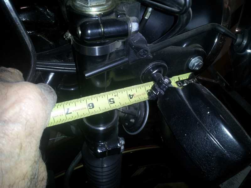

Thanks Kawboy. I like the ones I found on Ebay for that price range. Polished aluminum with different shims for different size forks. Anyone know the measurements from the fork tube to the headlight bucket holes? I want to get them long enough so I can make holes to mount the turn signals rather than mount them where the headlight bucket bolts to the headlight ear.

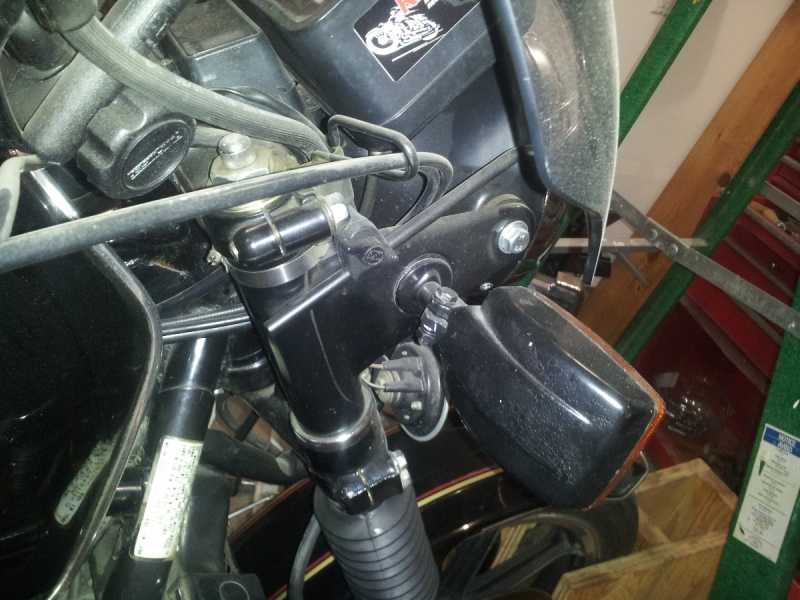

Mellvis wrote: Thanks Kawboy. I like the ones I found on Ebay for that price range. Polished aluminum with different shims for different size forks. Anyone know the measurements from the fork tube to the headlight bucket holes? I want to get them long enough so I can make holes to mount the turn signals rather than mount them where the headlight bucket bolts to the headlight ear.
Hi Brian,
I found five inches from the center of the fork tubes to the center of the headlight pivots. The turn signals are right in the middle.
Here are a couple of pics.
Hope this helps.
The following user(s) said Thank You: Mellvis

No eBay APP ID and/or Cert ID defined in Kunena configurationThanks Bill. The ones I found on Ebay are 15 cm (5.9 inches) total length so they should be almost an exact fit. Looks like I would just have to drill holes for the turn signals.
