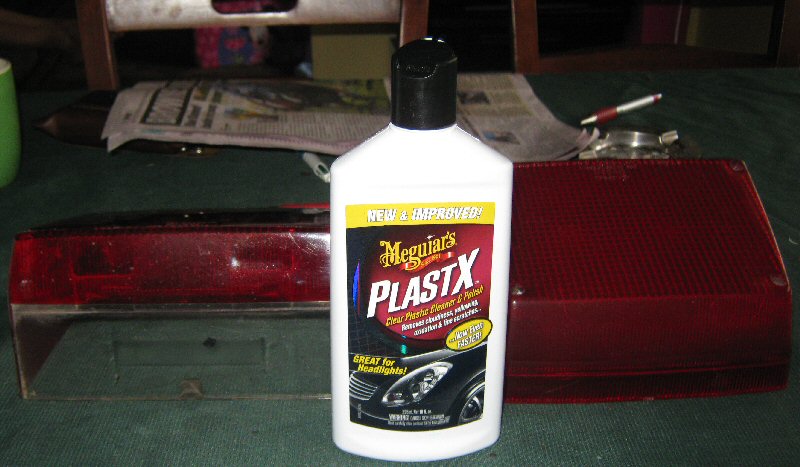

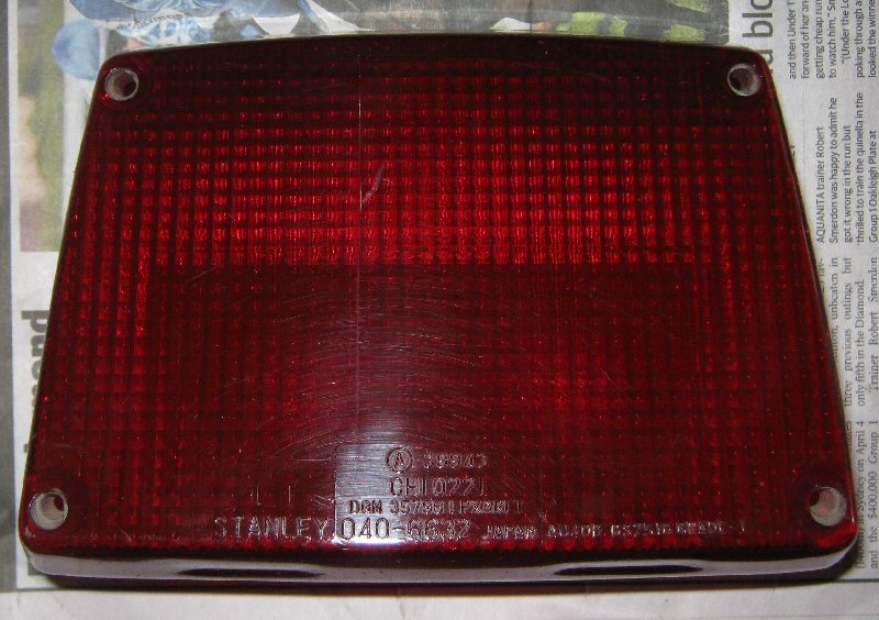

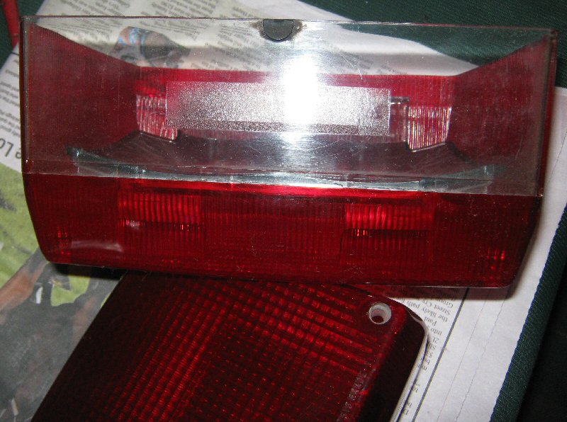

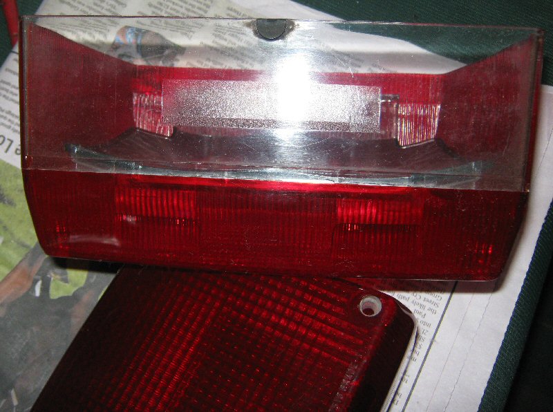

I have a couple of stop light lenses and after being in the aussie sun for a lot of years they got sort of dull and cloudy, thought i'd give that Meguiar's PlastX clear plastic cleaner and polish a go, seems to work well, just did a bit of a polish and they are clear and shiney, bit more elbow grease and they would be great, just thought i'd let you know, cheers Pete.

I like it !! Any chance Meguiar's put a UV protector in that product?

Kawboy wrote: I like it !! Any chance Meguiar's put a UV protector in that product?
lets see how it goes in the aussie sun, i'll let you know in another 36 years :-)
