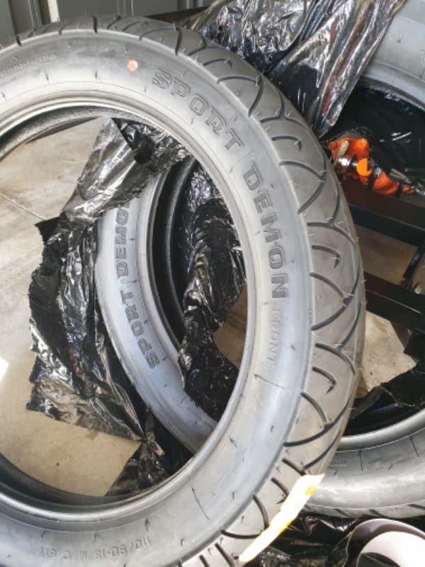

Tire choice is on about the same level as choosing engine oil. There are lots of choices, so it goes something like how much do you want to spend , where you ride- that is , alot of straight roads or more twisty , hard braking type roads.
When new, the bike came with 110/90V-18 . front. 130/90V-17 rear.. And with a tread pattern that maybe not available any longer.
Dunlop D404 are very common on bikes like this , but have a tread pattern that is quite flat -but it puts most of it's rubber on the asphalt and lasts ok.
Better if the road is mainly straight . So that would be a 130/90-17 M/C 68H.
Another bike I have is using Bridgestone Spitfire -same tire size. Were on the bike when I bought it. Much better for twisty roads. More like the Sport Demons.
