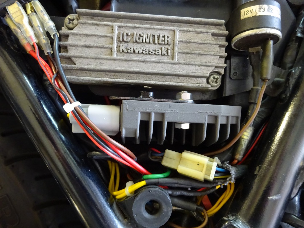

6 years 1 month agoNeville wrote: My solution has been to fit the best quality stator I could find and replace the shunt unit with a Shindengen series type regulator (SH775) - see www.kz1300.com/index.php/forum/welcome-n...r-with-1979-z1300-a1 - page 4.
Hope this is helpful
Just a warning - I have installed Electrex stator and Shindengen FH020AA MOSFET regulator rectifier from an BMW S1000R from a breakers yard. My warning is that almost all of the Shindengen reg-rects on evil bay are knock off clones. I know this because I bought one and it was putting 17 volts to my battery. A bit of research and I found that none of the clones mimic the exact cooling fin shape and configuration of the Shindengen RR - but they all claim to be Shindengen! I suspect all of the ebay clones to be dangerous

Yes - I would support your warning - there is a good description on YouTube on how to spot the poor quality imitations. There is no such thing as an inexpensive Shindengen - if it's cheap, it's a fake.

I was quoting someone else but I have found these to be excellent quality. However, it will still suffer from the poor design of the original shunt reg/rect and 3 pin connector.

The best I have found so far is the Electrex - with the fly leads connected to the windings in the same way as the original fit unit. I've had 3 failed Lin Sheng units - the stator temperature was high enough to melt the solder connecting the fly leads to the connector terminals.

My solution for my 80A's stator eating, is the SH847.
