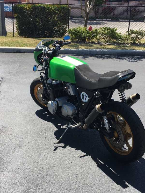

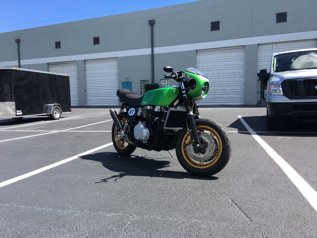

Re: The never ending project
I finally got my fuel problems sorted, only took a year and tons of fiddling.
I had fuel starvation problems over 6000 RPM that drove me crazy.
I made the double fuel line supply to the carburetors, fuel line from fuel tank supply fuel in a gentle down slope.
I changed the float valves from 2.5mm to 3.3mm for faster filing of the bowls.
Main jet is 110
Shimed the needless up a little
Modified K&N filter pods to fit these carbs
Just got back from 760 miles trip this weekend and the bike run so good had a blast.
All the hard work, hair pulling, mistakes, hours of resurch in this forum and other websites paid off big time
