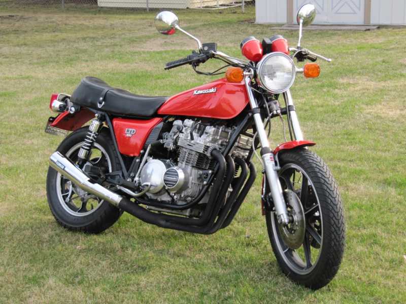

I use a rattle can product on my exhaust, VHT ceramic header paint. No its not as good as a professional coating, but for $10 is has held up very well on a bike I drive regularly. The picture shows how well it has held up over the last 5 years... not to bad for $10.
