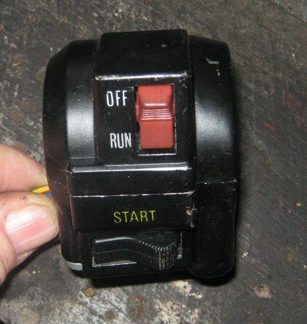

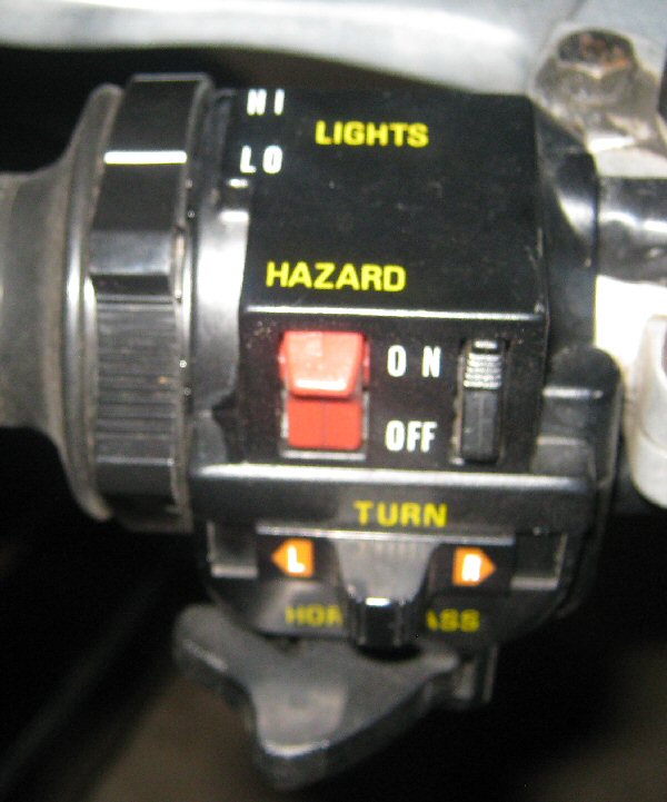

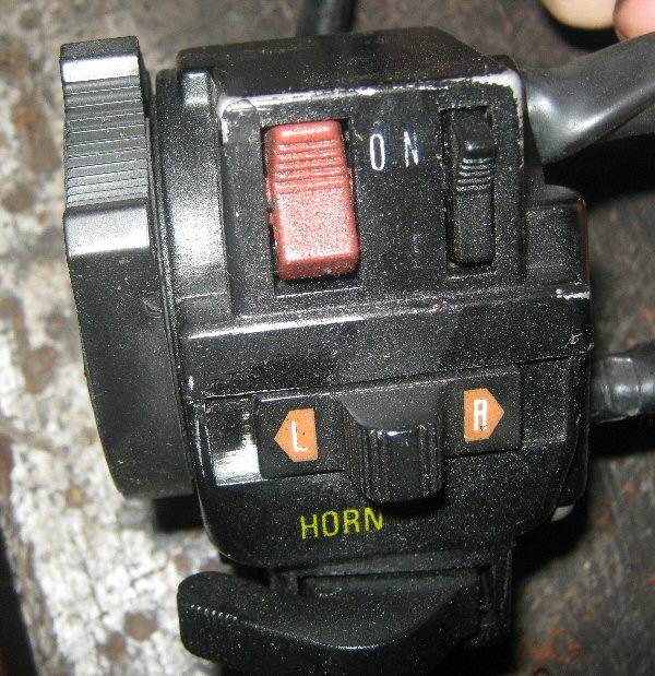

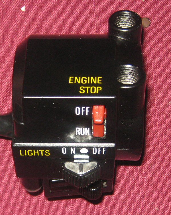

Pictures are worth a thousand posts
Australian left hand switch block
American left hand switch block
American right hand switch block
Australian right hand switch block
yeh the little black switch is the blinker cancel

KZA13.............
Just for the record...............
Your first photo is a EURO UK RIGHT Hand Switch (with throttle cables holes at top).
Second photo is RIGHT HAND USA Switch (throttle cable holes on bottom)
Third & Fourth photos are both LEFT HAND Switches.
Regards
Regards
