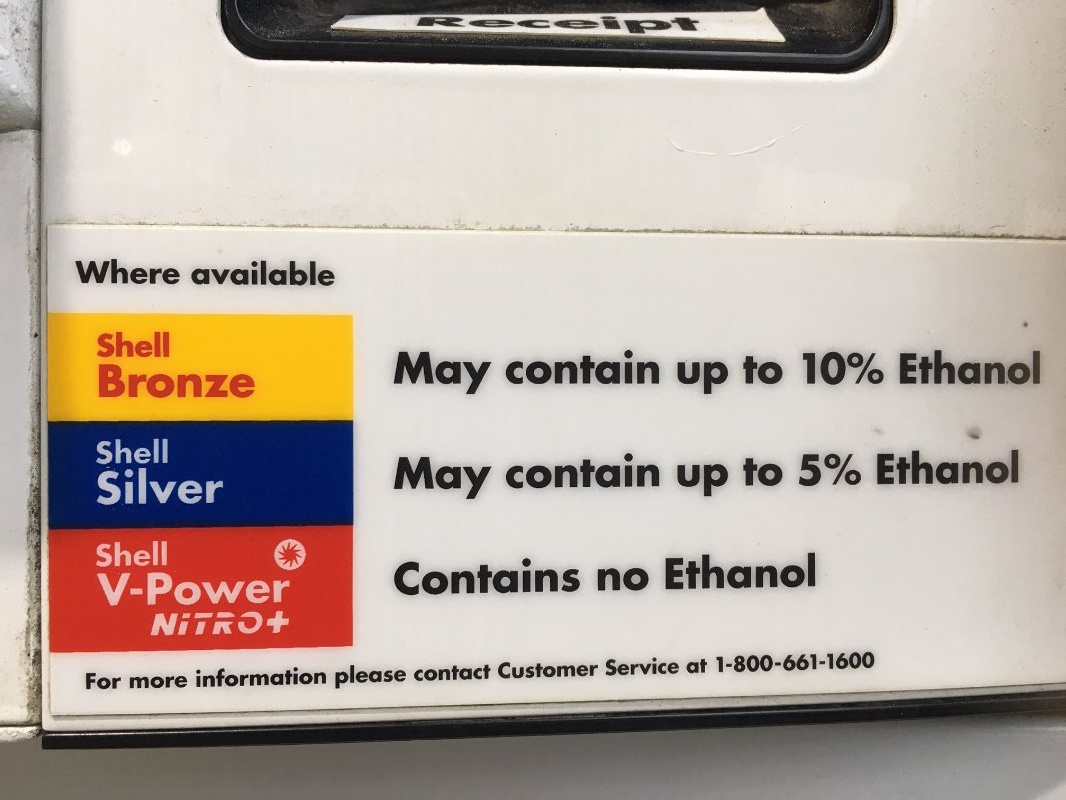

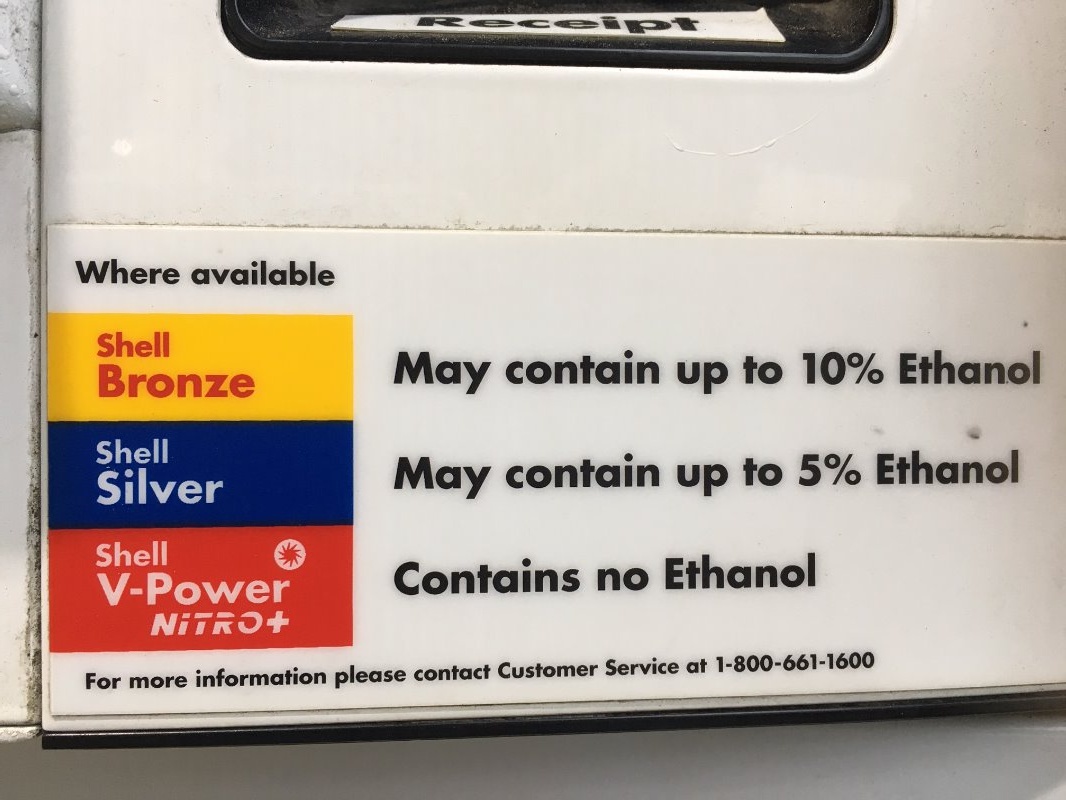

I've read very bad stories about the Stabil usage. I'm not trying to question what Kawboys is saying, but I can't ignore what I've read. At the same time, I swear by my using nof Ethanol free gasoline. There is no grey are there - it's bullet proof. These carbs, and all the old bikes, were designed for ethanol free fuels. And a sa solution for safe winter or any long storage, why not to fill up and run the bike with ethanol free gas for once? If not available, it easy to make! Just dump some water in regular gas, shake it and let it sit. The added water will absorb the ethanol from gas and separate. It's easy to simply syphon the totally ethanol free gas now into another container. There are even videos about it on youtube if this sounds confusing. I am lucky here where I live - I get Ethanol free gas at the pump. Cost extra, yes, but it is not by that much in the long run. Especially that I have more than one bike to ride and the other one uses untreated regular gas with no problem. But if I was going to store it, I'd still fill it up and run with 100% Ethanol free for the peace of mind. I guarantee - when you will open the carburetor bowls after 6 months, they will look shiny as if they just came brand new out of factory.

Sta-Bil and Sta-Bil 360 are 2 completely different animals. I don't even know why they still sell Sta-Bil. 99% of all gasoline has Ethanol in it. It's extremely rare to find consistent suppliers of Ethanol free fuel. Sta-Bil (the pink stuff) is useless for Ethanol supplemented fuel. Sta-Bil sells for $9.99 for 236 ml here in Ontario. Sta-Bil 360 is $10.99 for the same size container. PAY THE EXTRA BUCK AND GET THE RIGHT STUFF !!!

Hahaha! It's a very touchy subject for Kawboy. All I'm saying is, why not to spend the extra buck and buy ethanol free if available, instead of buying ethanol containing gas and treating it for ethanol contamination? If drinking dirty water makes you sick, you stick to clean instead of continuing chasing antibiotics with dirty saying hey, no problem, I never get sick. And yes, making ethanol free is easy and Chevron does not contain Ethanol - I tested it. But if there are trace amounts, that's definitely less than the written 10%!
