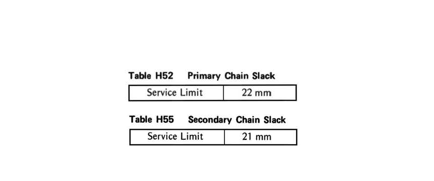

Great! Thank you for clarifying this Kawboy.
In both cases, I'd probably exchange either if they were close to 21 anyway! How long does it take to go over it? I'm not even sure I could take a precise measurement lying under the bike..

It's a simple up down free movement of the chain midway between the drive and driven chain sprockets. should be able to do it with a scale. Like you if I found the chain slack over say 15 mm, I'd change them out.
