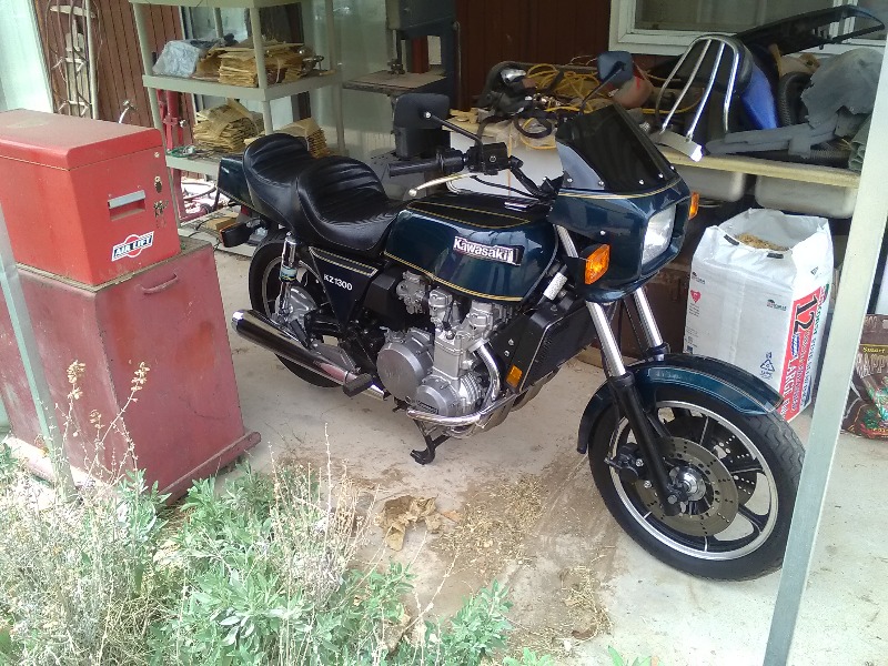

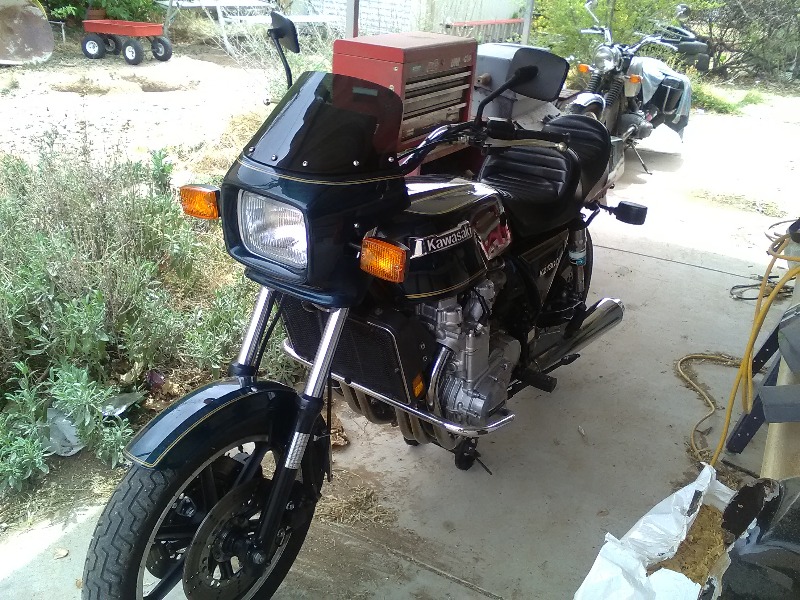

The bike looks superb. Do you know if the bike was run without enough engine oil? I wondered how it came to have the knocking big end bearing.
  • Posts: 3292
  • Thanks: 1223
Re: Noob here, question about fairing
#19432
That's a georgous looking bike. i'm shocked that there's a lower end knock. Anything's possible I guess. Such a shame. If I didn't know better, I would have expected it to be in fine running order. Usually anyone who looks after the appearance, is anal about the maintenance. Before you go tearing it all apart, I would do a oil pressure test first, just in case it's the oil pressure relief valve is stuck open. Who knows, you just might get lucky. The "other" thing that seems to crop up quite often when we do tear the bikes down is all kinds of crud built up on the oil pick up tube screen. There are some really nasty pics on the site of what the boys have found stuck on that screen. The oil pressure test wil tell you something, but if the oil pressure is low, the first thing to check is that screen.

Kawboy wrote: That's a georgous looking bike. i'm shocked that there's a lower end knock. Anything's possible I guess. Such a shame. If I didn't know better, I would have expected it to be in fine running order. Usually anyone who looks after the appearance, is anal about the maintenance. Before you go tearing it all apart, I would do a oil pressure test first, just in case it's the oil pressure relief valve is stuck open. Who knows, you just might get lucky.
No, for sure it's bad. The bad rod was in the box of parts I got. The engine is just bolted together for sale purposes. Seems like a lot of work for nothing. So far all parts look like new. The one piston that is out looks new. I'm very hopeful. Paid 850 for it and if I can fix it for another 500 I'll be happy.
