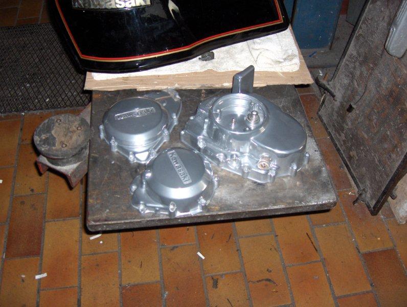

none of them had been chromed in OEM. SOme I know had theirs chromed, however it is risky at the chrome plating might drop of later. I had mine trowalized which gave excellent resulst and made them somehow a bit more resistant against water-staines and oxidation.
It is finally up to your taste, though my idea is that the polished/ trowalized last longer.

My covers had the chrome badly peeling off and the underneath pitting and discoloration of aluminum was terrible. The bike had been sitting in bad conditions for a very long time. First the shop removed the plating chemically, then they polished them and then chrome plated. They look fantastic. On the other hand, I do love the look of polished aluminum, but was afraid that the discoloration on aluminum will stay. I got one of the covers back with just removed plating and polished, and it look great, so perhaps you could ask the shop to do that first and then decide what to do later. It would definitely be easy to continue polishing to high shine after a preparation done first by a shop. The old plating must come off first anyway.
