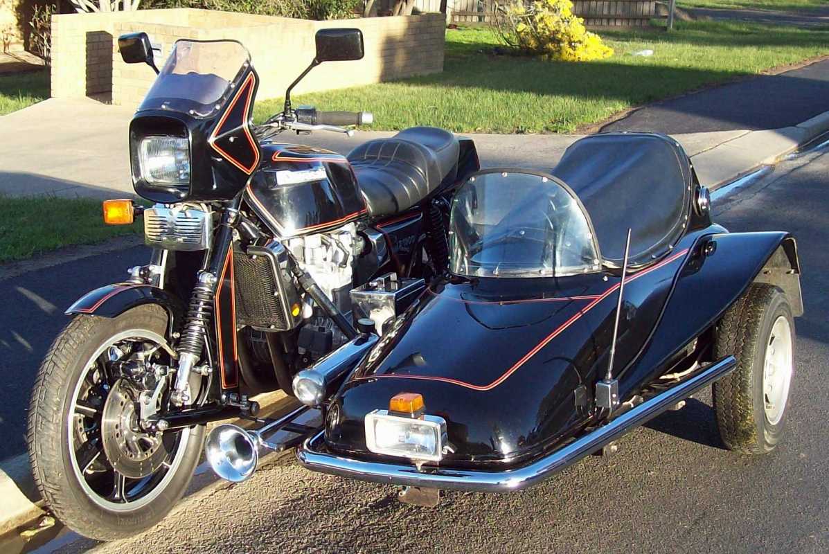

Welcome to the forum. You might recognise this Z1300 and where the photo was taken? It's been out of action for a few years but I now have it back on the road.
Regards
Regards
1983 Z1300 A5 plus Sidecar.
