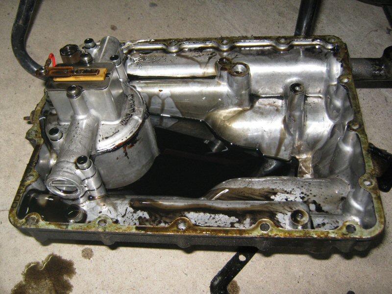

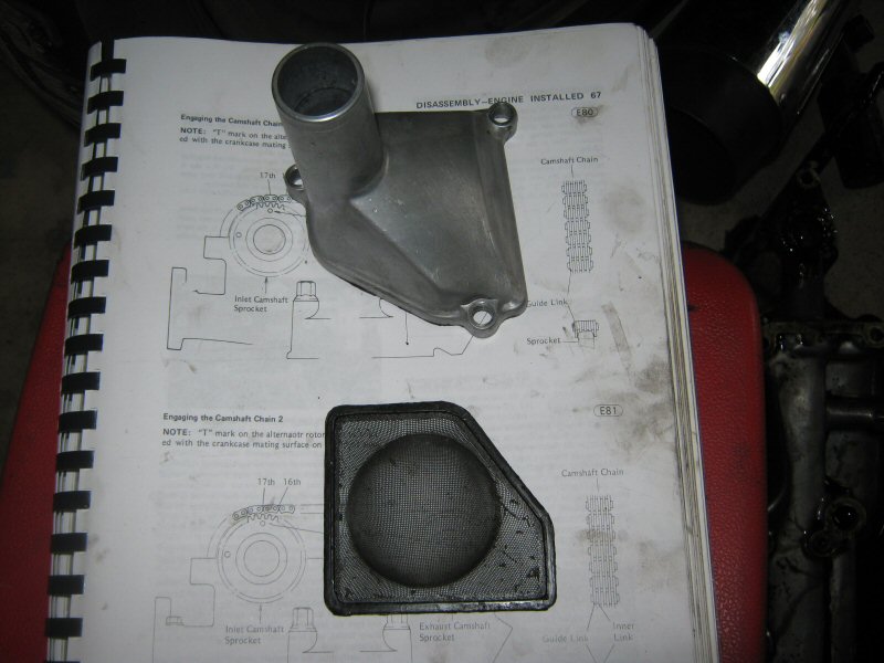

10 years 1 week ago - 10 years 1 week agodogfight wrote: Am I just being too gentle or what? I stopped for the day before doing something stupid out of frustration. Any ideas will be greatly appreciated.
Double check for a missed bolt, I always miss one somewhere
here's that oil filter screen to clean and my larger sump after I got it off mine a while ago (I have a 79 A1)

Well Guys, thanks for all your input. Yes I did drop the oil filter bolt first and double checked the screws and the front pipe is loose so checked off all boxes. The darn thing is just glued on there tight.
