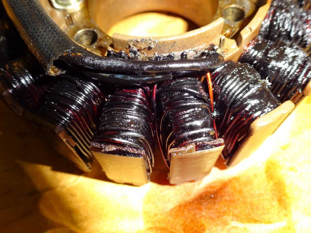

This is the stator I fitted 8 years ago which failed recently - oil pyrolysis evident on the stator coils and solder melted from the fly lead connections

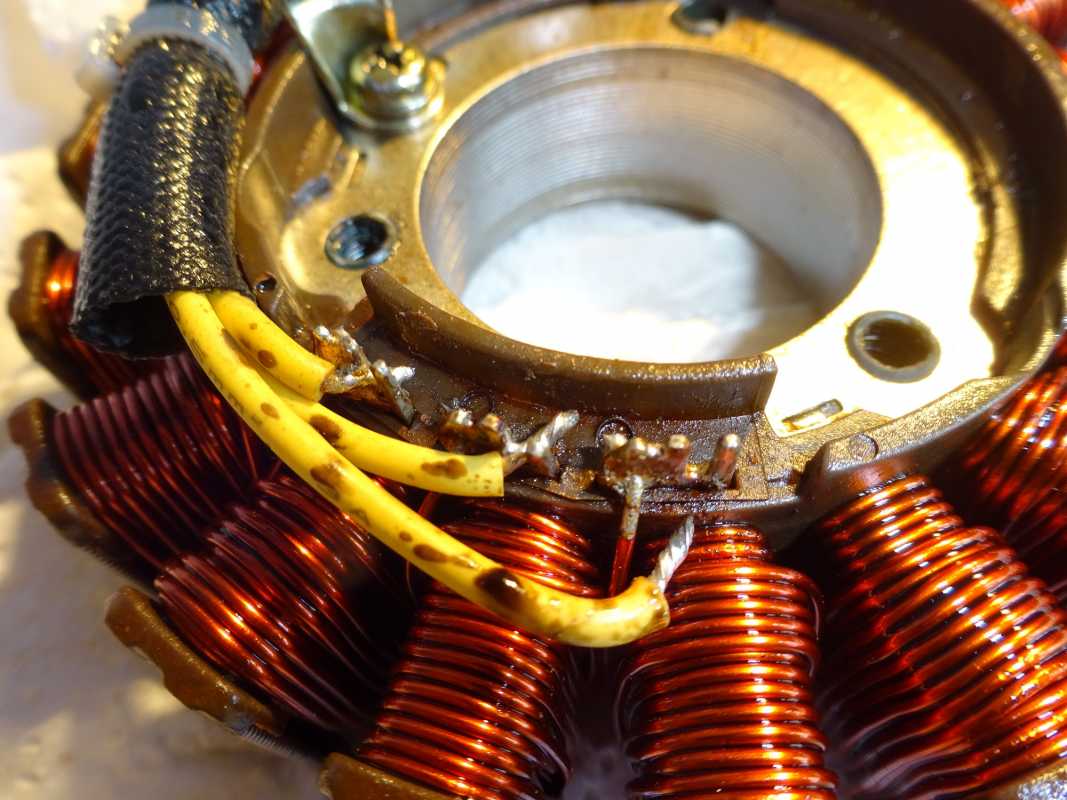

This is the new stator that failed after one ride:
Thanks for the advice - I would also agree that it’s likely I have a sensing voltage issue caused by a poor connection in the main power circuit. I have checked the 9 way connector next to the fuse box (removing the individual male/female spade connectors) but it looks like the main power line (usually the brown wire) connects through the main switch, another connector and the ignition switch before getting back to the regulator. I cannot be completely certain, but the stator failures occurred when I rode with the headlight switched on (this is the European model with a light switch!) - this could easily have dropped the main power line voltage well below the battery voltage if there was a bad connection - thus triggering the stator failure.
This has all been really helpful so thanks again for the advice. It will be a pain to find the bad connection but I will spend an afternoon with my multi-meter measuring voltages at all the connectors with the lights on..

Neville,
After careful inspection of your detailed stator failure photos, I owe you a better analysis. There is no evidence of coil wires shorted to each other, or of windings shorted to ground. Both stators failed in the same manner, with the solder melted off of all 3 output leads. This indicates excessive current flow through each of the three stator winding phases.
Since the original stator lasted 8 years, and the replacement failed in the same manner after one ride, something obviously changed that caused the failure of both stators. My best guess is that something is wrong with the battery. A shorted battery cell/cells is almost like shorting the stator output to ground. If you have a standard lead/acid battery, maybe it got boiled dry and the stator put out maximum current trying to charge it.
You mentioned riding with the headlight on. This would have increased the current flow through the stator and added to the heat load caused by whatever went wrong.
One other thing that would have made the situation worse would have been a low oil level, since the stator is oil cooled.
The first thing to check is the battery. After that, make sure all grounds are clean and tight. Finally, check the oil level and keep it at maximum with clean oil.
