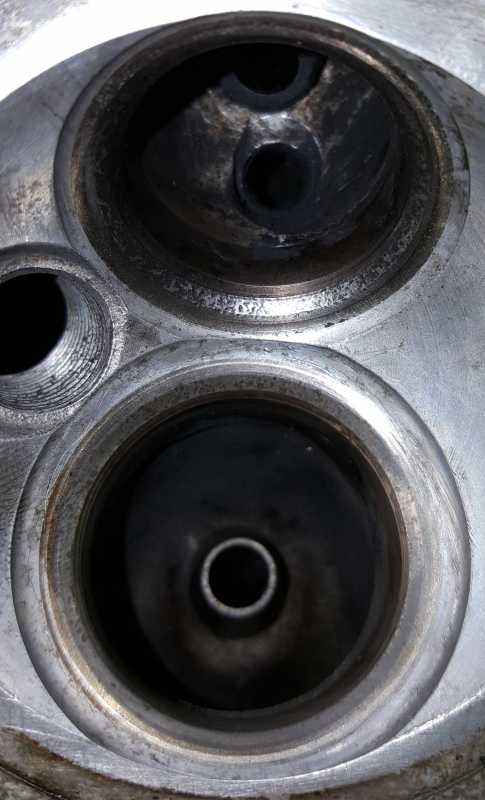

A photo of one valve seat after I did a quick clean off of the carbon crap. They all pretty look much like this.

Yaegunp wrote: A photo of one valve seat after I did a quick clean off of the carbon crap. They all pretty look much like this.
Time for a "valve job" Bro. I can see carbon impregnations in the valve seats and the contact area ( the shiny part in the middle) is too wide. When the contact area is too wide, the sealing pressure is marginal and that's when you end up with the carbon impregnations. I suspect that if you look at the valve faces, they'll be cupped. Hopefully, there's enough material on the valves to reface the seats. The head won't be a problem.
For the record- because the valve seats are too wide, you can't just use valve grinding compound and clean up the seats. It's beyond that.
Anyway, you've gone this far. Get the valves and valve seats cut and carry on with your rebuild. It's all good. You'll get a lot of joy out of your rebuild after it's all done.

As Kawboy has said the head needs a complete resto. The valve guides in the exhaust port is a bit frazzled.
You probably wont find a used head in any better condition so just bite the bullet and get it done it will be worth the cost.
