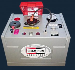

Also for the old Dogs out there. Remember the old Champion Spark plug cleaner/tester?
Give the old plugs an abrasive blast and then an air blast to clear the abrasive media from the plug. Then screw the plug in to the test chamber and apply compressed air and watch the spark in the glass window. You could throttle the air and watch for the spark to stop and read the gauge and see at what point the spark plug would fail (at what compression). Most plugs with 10,000 miles on them would fail at 60 - 70 psi. A good plug would fail at 100 psi. It was a great tester but as a cleaner often left abrasive beads on the bottom of the spark plug which was often accused of piston ring failure down the road. Then spark plugs got to be so cheap that cleaning service cost almost as much as replacement so these old babies went by the wayside
