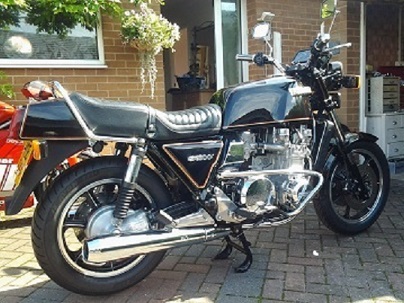

Finally own another 13 :)

Ta, looks like black is a favorite colour for us here...always been my choice
