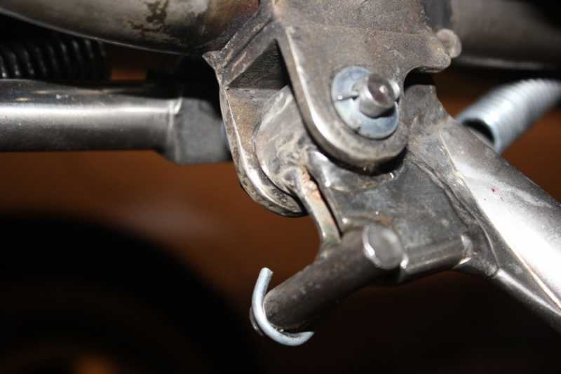

ok so the bolts are just spinning and not coming out wtf is going on ,ive got the nuts off on the inside,springs off and hit them hard with a hammer and still not coming out ,so i need a little help here guys ??lol ive got the whole bike stripped and i can not get the last bolts out

If I remember correctly the shoulder bolts thread into the back side of the holes and the nuts are just lock nuts (check me here guys). If the threads on the back side are stripped what's left acts like a nasty circlip. The bolts spin and never back out. It's time to use a drift, brass if possible, and drive 'em out.

Correct Bill. Sometimes if apply some pressure to the bolt wether it pushing or levering some how whilst trying to undo it will most time come out. I do state most times .lol

ok cool its just spinning at this time so ill try some pressure and a drift then its the dremel lol and then off to powdercoat

Sounds like the formerly threaded end of the bolt might be a bit flared as a result of trying to drift it out. (hence the previous suggestion of using a brass drift) It's going to be laborious but drift the bolt back IN and then clean off the remaining threads with a file and try again. If it doesn't come out easily then reset it and file it down (round) some more. Once out clean it up as required and drill a hole through it for the appropriate size mini hitch-pin. Allow for a washer. While on the topic of C/S's I did a tutorial on how to modify the center-stand so it will "fit around" the DG header. Real easy ! I also did a tutorial on shortening the C/S to make getting the bike up on it, much easier. Good time to consider these ideas, while it's off.
