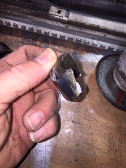

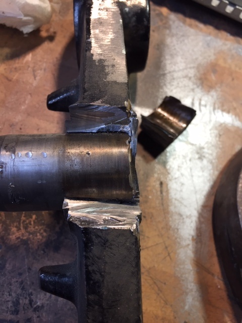

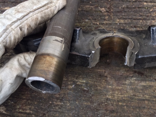

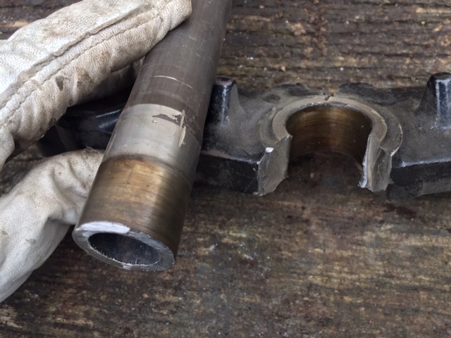

OK, I got it off.
I had to grind very deep to get the bottom weld off, so by the time I could see the pin distinguished from the yoke, much of the yoke was gone. So I cut sideways and in the end I could cut a piece out, force the yoke open and press the pin out.
From the pictures you can see it is a simple press fit (steel on steel) and welded at the bottom with a thick weld. The bearing race seat is part of the yoke, with top bit unpainted.
My advice: if you ever need anything done with this, buy a new/secondhand one. Unless like me you need just the pin, its not worth the trouble.
But at least everyone now knows how this part fits together!

Success. You got your yoke shaft out and that's all that counts. It's a difficult spot to have to cut a weld out. A dermel tool and a hand full of small cutting discs or you could have machined it out on a lathe if you had access to one with a big enough swing. All that counts is the end result. Kudos.
