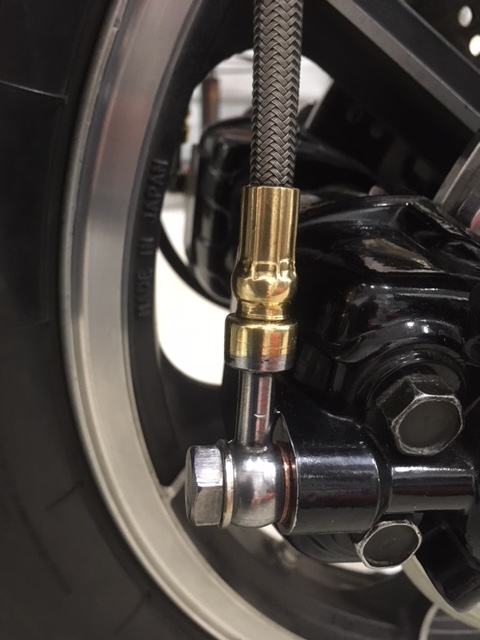

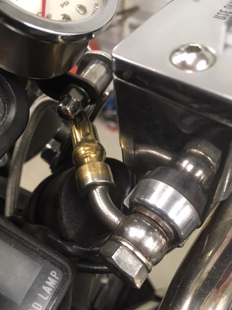

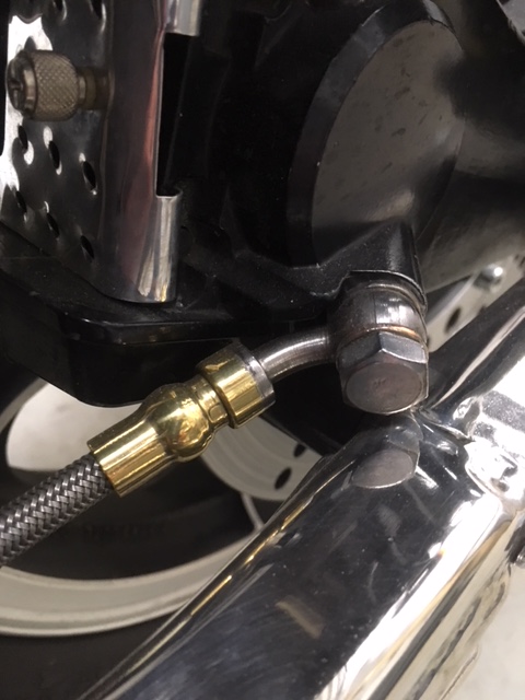

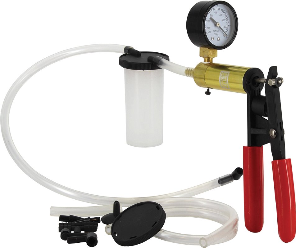

mlyle11 : Can't really advise with any purchase experience as I made my own S/S braided lines, many years ago. At the time I couldn't afford commercially available lines but my brother worked at a shop that among other things specialized in hydraulics so bought some bulk S/S line along with the compression fittings. I removed the banjo fittings from the OEM's, cut them off at the major diameter, brazed them to the new compression fittings and had the shop crimp them. They haven't blown-up yet so must have done something right !
Many line-kits are available through various sources

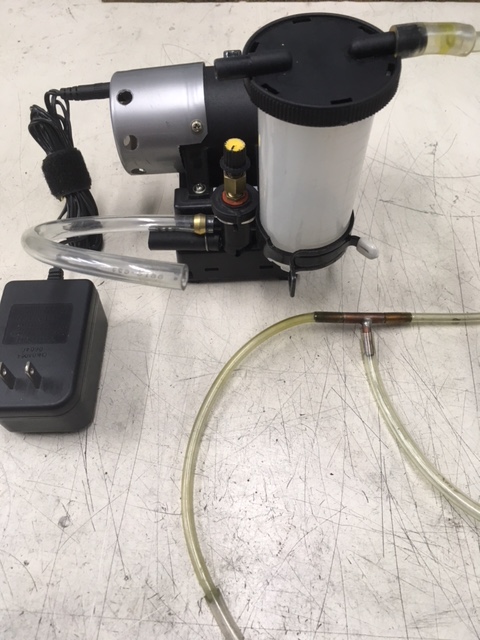

Purchased one of these vacuum pumps a few years ago and it works well for bleeding brakes

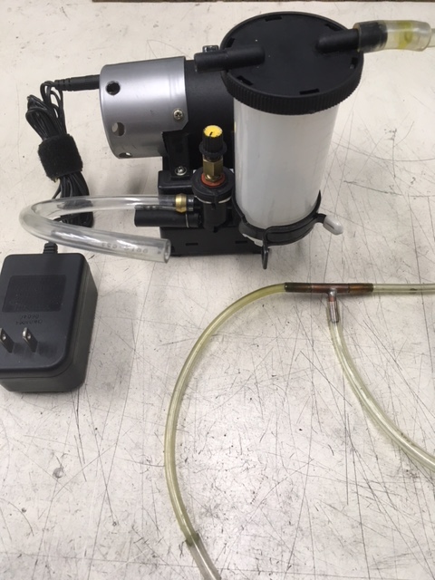

Then..........Came across a discarded kitchen vacuum bagger and had a "scotch" moment,
Works brilliantly! With a Tee fitting, I can bleed both front calipers simultaneously, in one shot, but really have to pay attention to the reservoir level !

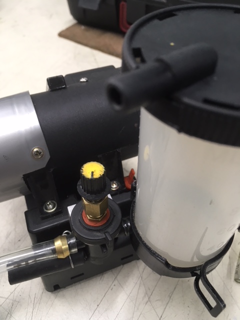

The pump will draw down to 20" Hg. Not shown is a vacuum gauge I connect, to adjust the Yellow knob which is a needle-valve that controls the vacuum. 1.5"HG to 2" Hg vacuum, is the best range to remove fluid/air, but not so fast I loose the reservoir, too quickly. When the last of the air is drawn out I keep the pump running, shut off the bleeder nipples, then turn off the pump.

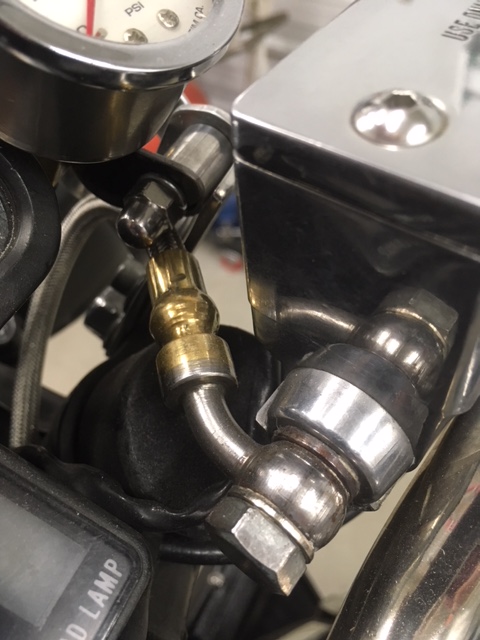

One thing that can help is countersinking the hole in the end of the banjo bolts. The end of the bolt creates a 'shoulder' that can trap air bubbles and countersinking the end eliminates (or dramatically reduces) the shoulder.
Alternatively, 'Bolt bleeding' solves the trapped air problem but that's a bit of a messy option (and hard on paint if using DOT 3, 4, 5.1). The banjo bolts in my old Honda are countersunk from the Factory.
