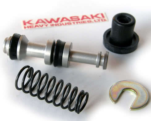

Re: Rear Brakes
12 years 6 months ago
Mikez,
If you look at the image below, its a photo of the FRONT MASTER cylinder seals & piston kit.
The rear one is pretty much identical.
On this you can see the Tapered Type Seals I meant ?

Re: Rear Brakes
Right on I see what you mean. Looking around I've found that those seals are usually called epdm brake rubber cup seals.
They're commonly used in hydraulic applications. I'm looking at different kits right now to see if I can find someone that sells assortments lol.

- wrgoo56
- Posts: 120
- Thanks: 13
Re: Rear Brakes
12 years 6 months ago - 12 years 6 months ago
Buy the kit for the front and take the seals off the piston and put on your rear piston they are the same size. Now as to the bore being bad as suggested you can drill it out and hone it. Or there is another option and that is to sleeve the bore .
