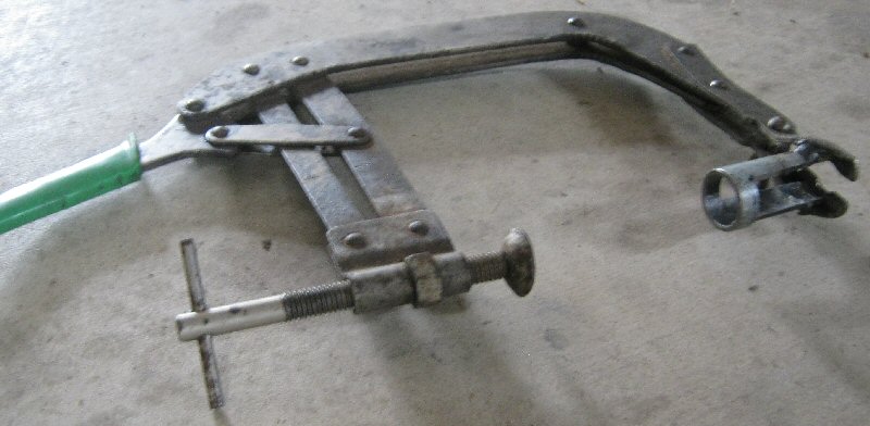

Pulling the valves shouldn't be too hard, so long as you get the right tool. You'll need the valve spring compressor that looks like a large C-clamp. The ones that grab the spring from the top and "pull" it up won't work, as most of the spring is buried in the head. Just be sure to keep ALL the buckets and shims separate, and put them back where they came from. DON'T MIX AND MATCH!

I did the seals a while ago, had the head off during a re-build, I am an average aussie and ain't got any spare dosh (money), I had an automotive spring compressor and tried to use that, because of the angle of the springs and valves and the width of the head I found I couldn't compress them enough to easily take the retainers out to free the valves, so I cut a piece of pipe and tacked it onto the compressor foot, cutting out the sides of the pipe allowed me to easily get at things, make do when you have to, worked for me
