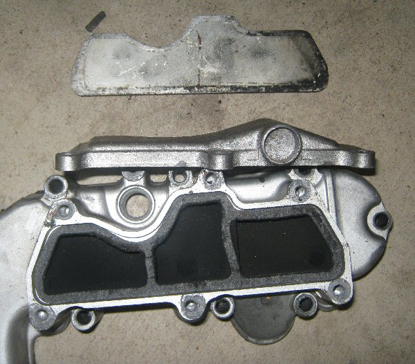

Photo of the plate that blocks the reed hole

Or a Canadian model which also did not come with the reed valves (at least the earlier models didn't)

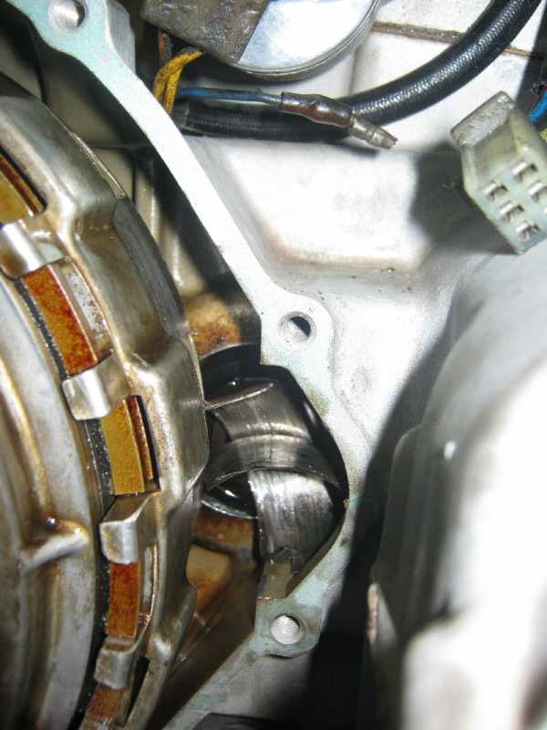

This is what caused my clutch basket rattle, bearing wore out on the end of the secondary shaft, yours won't be as bad as that :-)
