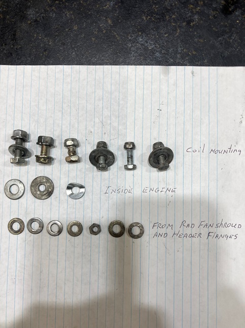

The 4 Washers and the Nut ? Hit the floor while removing the Fan and Header collars? 3 more inside the engine including the bent one which appears to have gone through gears (somewhere !?)

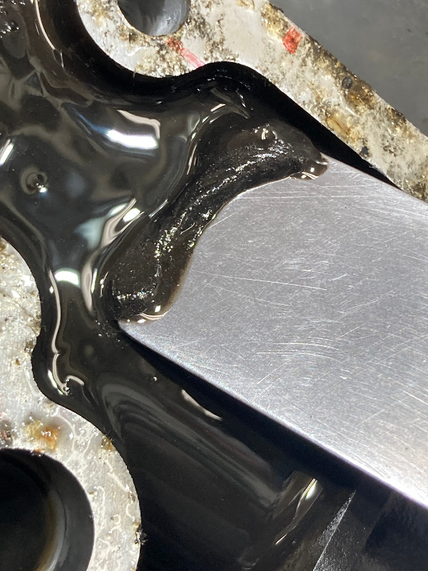

The sludge in the Head? The entire inside of the Head was coated in it. I had removed almost all of it when I decided to take the picture....for the "Historical Documents" !

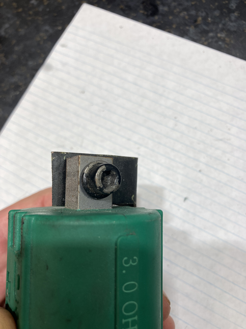

Corrosion on the S/plug terminals was a surprise, given the boots were intact and fit tightly.

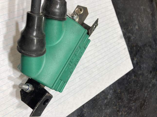

100% certain the errant washers and the Nut are from a P.O.'s Fumble-Fingers, trying to install the Nology Coils WITH THE FUCKING CAM COVER REMOVED AND NO CHAIN-TUNNEL COVER !!!!!
What does any proficient mechanic do when he drops a fastener: Get another one .....and repeat and repeat ..... with the additional philosophy of, "Outta Sight, Outta mind" J.H.C. !

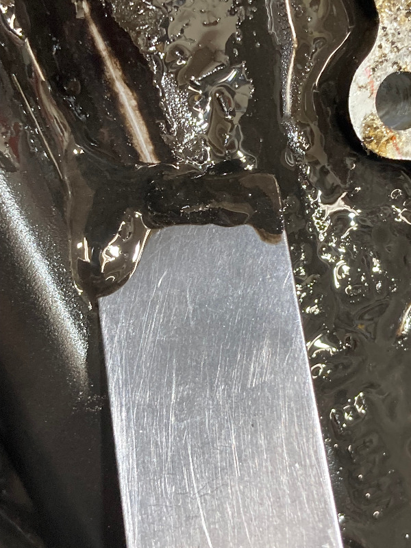

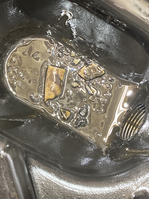

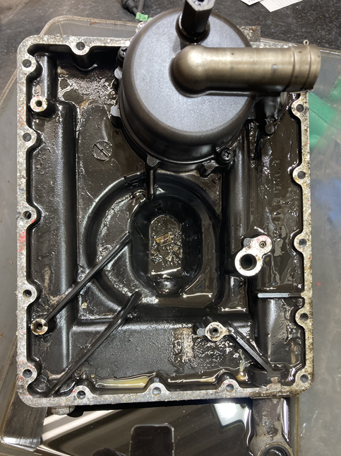

The oil pan came off yesterday and I was almost disappointed with the lack of what I found. Surprisingly clean ! Some pieces of epoxy from the Alternator rotor in the sump and some areas of the screen blocked with grime but nothing that gave me any concern. I fully expected to see more "hardware" in the Pan, but on the other-hand, glad I didn't. The oil-pan had a thick coating of sludge. A full 1mm on everything. This suggests to me that this bike has sat still for long periods of time allowing the "crap" in the oil to settle-out".
I flushed out the main oil passages which had the same slime and the Pan is back on.
I couldn't get a good picture of it but I was surprised to see the Cam-Chain completely off, hanging a couple of inches below and to one side of the secondary-shaft sprocket. (?) Previous experiences with cam-chains in my '80 and recently finished '79 have led me to believe that it wasn't possible for the chain to disengage in this manner. Having had cams out/heads off in both bikes....more then once.....I've simply let the chain drop into the well and had virtually no problem retrieving it with a hooked-wire. The chains NEVER came off the sec/shaft sprocket. And it's this point that brings me full-circle to this bastard:

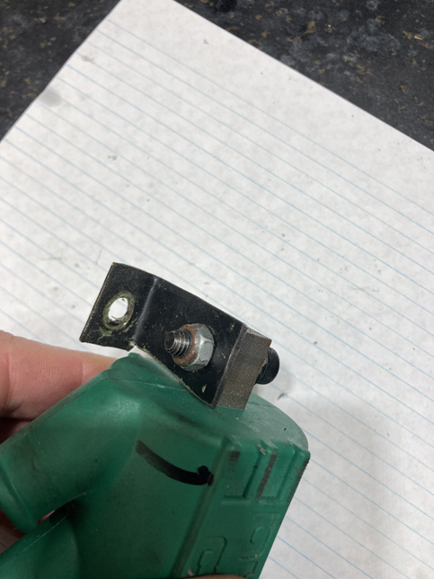

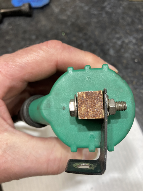

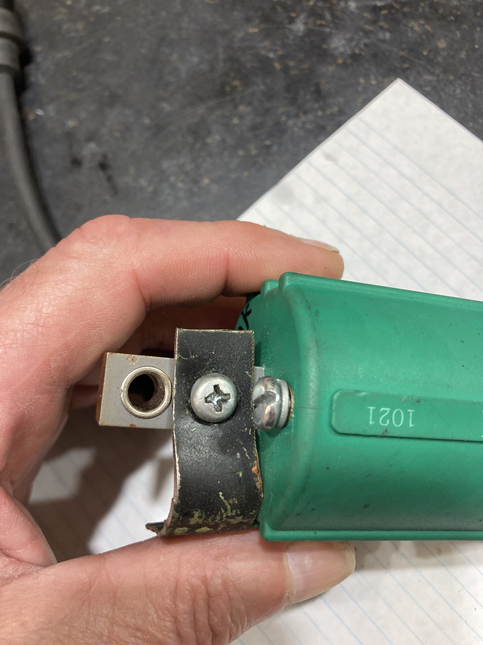

I now have a reasonable theory about how all of "The Hardware" came to be in the engine. And lets not discount the 5 (?) pieces that hit the floor when removing the Fan and Header flanges.
A scenario involving the mounting of the Nology coils, the various types and sizes of nuts, bolts and washers and the awkwardness to get a socket/wrench on them due to the homemade brackets, used.
And those damned brackets with unfinished edges and corners are as sharp as they appear !!!
Seems obvious to me now that the "Installer" of the coils struggled, so with the cam cover removed (already or specifically for the coil installation for more room to work) the washers began to drop !

I love puzzles but not when they cost $1200 +

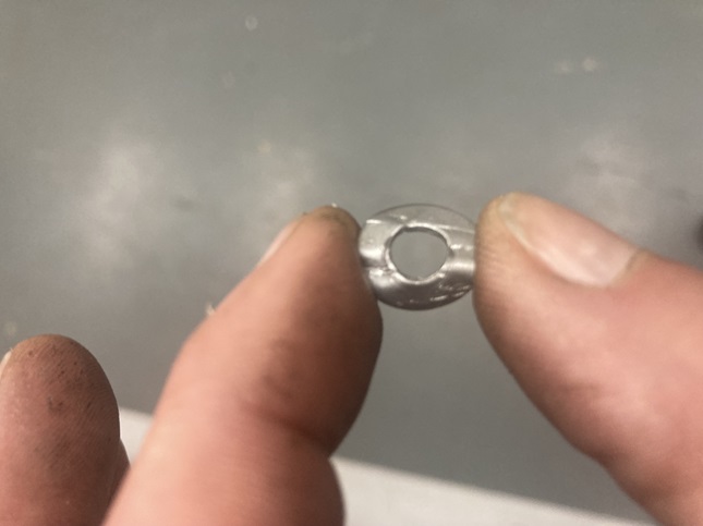

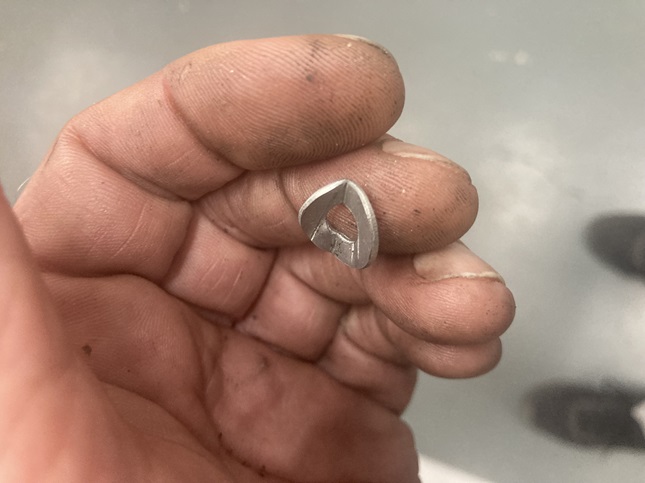

Looks like a 6mm aluminum flat washer and folded up when it got caught in the cam chain ??
