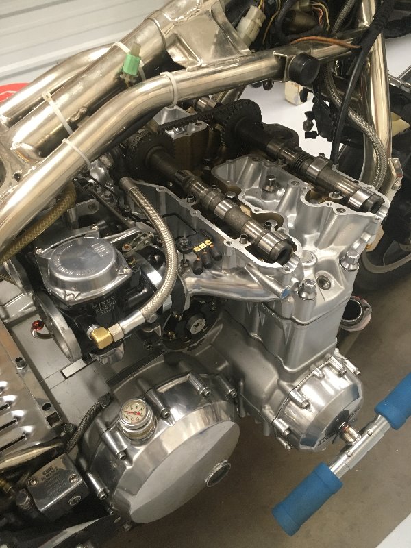

I spent last Sunday afternoon putting things back together. Piston rings were "clocked" at the bench. I ended up using a large sewing needle to move the oil-ring pieces. I pre-shimmed on the bench.. This worked out well. I need to buy 6 new shims but the shims that are in these specific valves at least allow the cams to be installed. NOTE: You can not rotate the cams without ALL shims (any size shims) in place. The cam-lobe(s) will become "trapped" in the empty lifters !

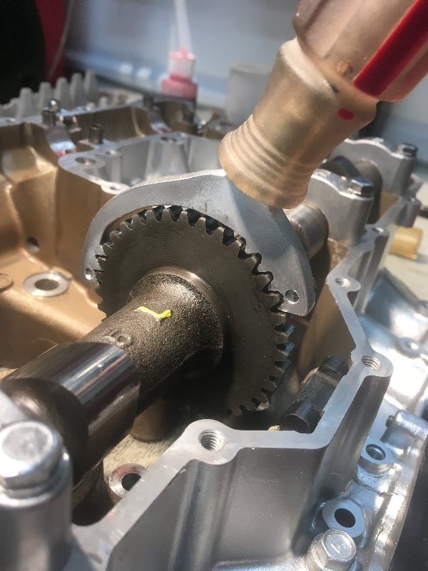

The cams, being independent without the cam-chain, wanted to self rotate so I made this. Well worth the two hours.

You’ve made good progress, scotch.
Excellent work with that cam sprocket holder.
Have you painted the cylinder block / head? It looks good.
How did installation of the cam chain roller and chain go?

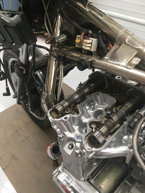

I feel uncomfortable seeing the cams in with the chain on and no cam caps on

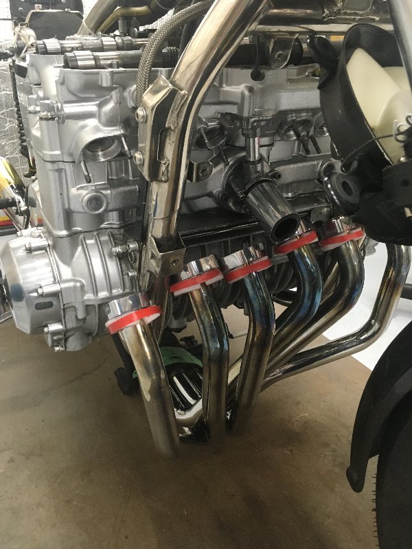

Hmmmm, Intake manifold test port above #5-6 intake tract. Interesting mod.

Me likee nickle looking frame!
Regarding cam chain, no caps.. my bet is no tension on chain from tensioner yet?
Really clean install Sir Scotch. Ready for another engine to work on? Oh SNAP, too early to ask?
