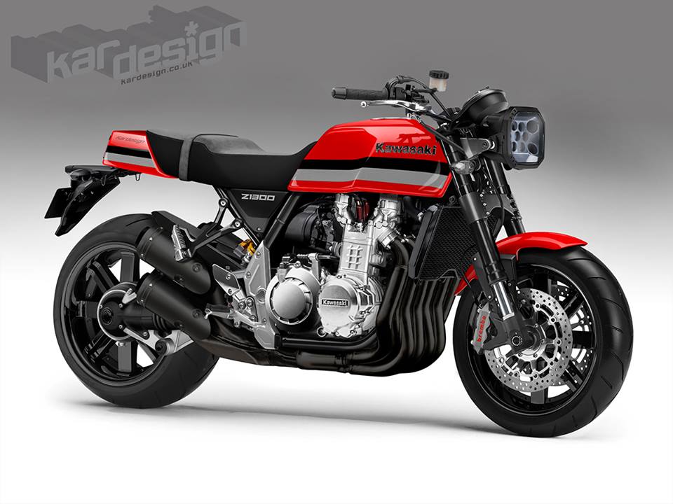

I have a brand new DG pipe in a box waiting to go on my beast BUT when I saw this pic
I knew I was going to have to build those pipes. Love the look and appreciate the design. 6 in to 2 in to 4. As far as exhaust design, the only more effective design would have been 6 in to 2 in to 1 I really wanted to spoof my KZ to appear to be a CBX but with a water cooled engine? Head turner. Then seeing this exhaust new I was going to have to build it.
Anyway, I digress. Looking forward to seeing your resolve here and I do appreciate your end goals as far as appearance. Quite unique. Kudos.

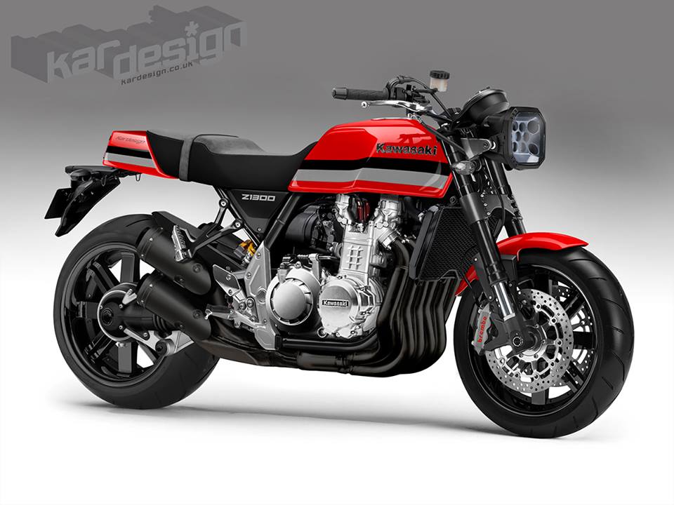

And yes, I have seen that design a while back. I just wish Kawasaki would actually build it!
.... maybe that is and idea for the next build - take an old z1300 and build it to emulate that one... !!

That computer rendering above of the Z1300 was done by a fella called Kar Lee, he would do a modern make over for a different classic bike every month on a page titled "Retro Re-boot" in Classic Motorcycle Mechanics magazine here in the UK. They asked for suggestions on what bikes to do next so I Emailed him to ask if he'd do the Z1300 which he eventually did. Not saying it was completely down to me as there were probably multiple suggestions for the Z1300 lol.
The following user(s) said Thank You: stocktoy, Kawboy, McBoney
- Posts: 3298
Re: What to use for loud exhaust?
5 years 11 months ago
I'll thank you for poking him to do it. It's awesome !! I just wish it was an overbore 4 valve per cylinder.
