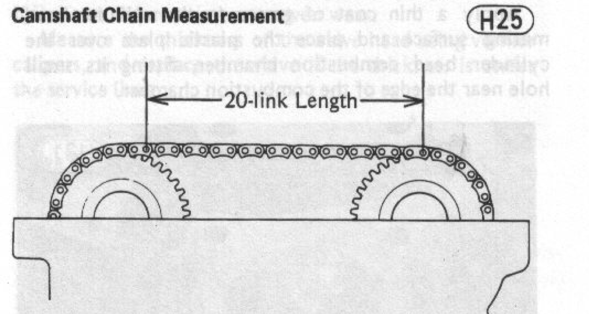

Ha! I referred to the manual. Please see screenshot I took.
It is measured between link 1 and 21! I counted the links in the picture.
My measurement is now nearly 13mm so right on the service limit.
