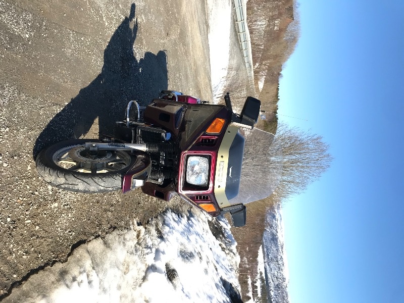

Update! It was a intake leak from the middle rubber boot. Kawboy you nailed it
Thanks!
I went directly on a 175 mile ride for testing. All good, engine runs great and smooth. No sluggish throttle response.
