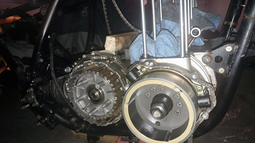

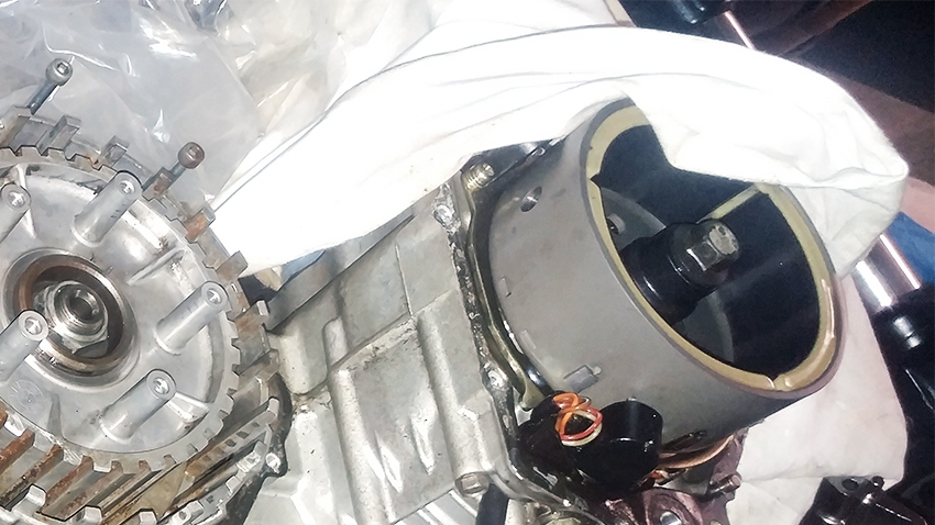

6 years 11 months agois there any chance you could post me a picture of your flywheel rotated so it shows me the trigger for the pick ups ( it has a timing mark with the number 2) the reason is the fly wheel I removed has 2 small triggers about 10mm by 8mm and the new one has 1 large plate about 10mm x 70 mm. thanks.

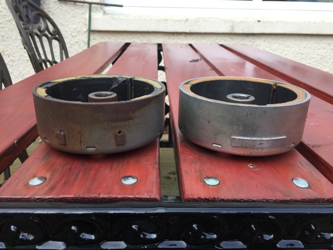

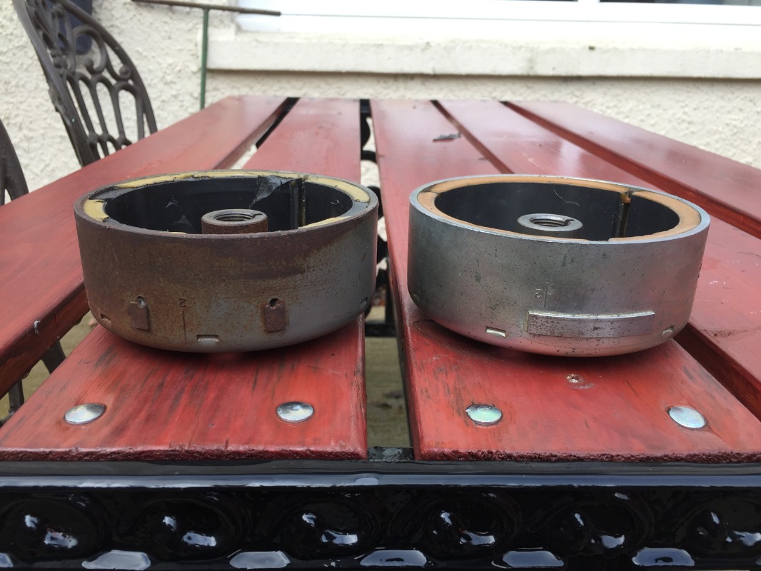

Thanks thats what I wanted that one is the same as the one I removed from my bike it has the 2 small metal triggers on it , the one I am replacing it with I think is off a DFI it just has one large trigger I think it will still work OK as the DFI has the same pick ups I think. I have attached a pic of my old rotor next to the new one you can see the different trigger plates on them.
