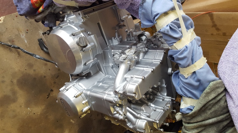

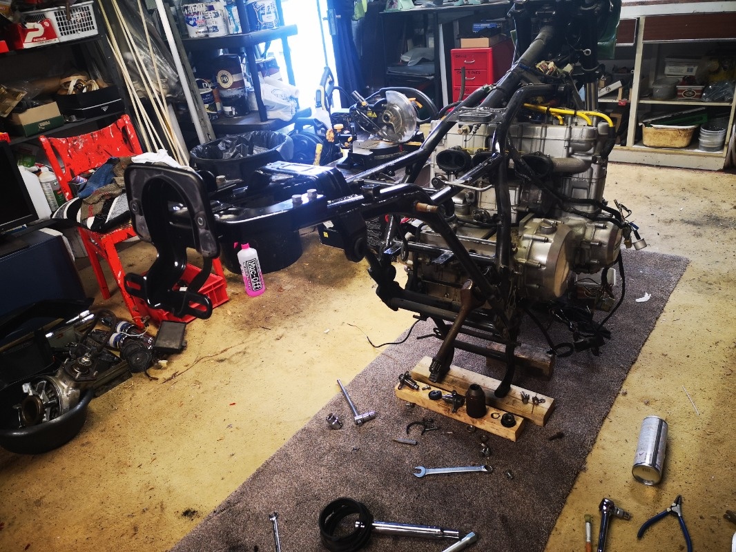

I'm here, I need to re-paint parts of the frame and the engine. I'm looking at it and thinking I should take that engine out really.
Does the engine come out whole, or does it need partial stripping? Is the easiest way to lay it over?
Re: best dremel bits to clean off old paint.
Remove sump, Cam Cover and any other casings you can.
Place and old mattrass or similar on the floor and lay frame and engine on its side and remove the frame from the engine, unless you have 3 or 4 good strong mates who can help you "wriggle" it out upright ?
I would leave the engine in and paint it, then cover it and do the frame as plenty of room all around it.
I did that this winter and it looks ok ??
