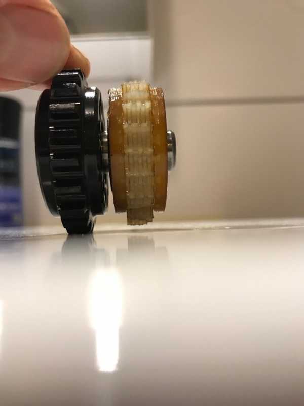

I have already recived a new cam chain idler gear from Liska, I attach a picture of new and old cam chain idler gear. My cam chain have 128,7mm and the service limit is 128,9mm. So is about time to replace it.

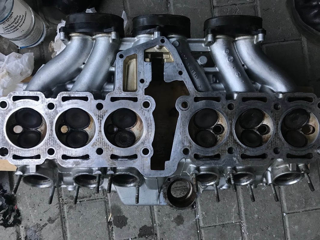

The cylinder head will need some work, thinking to delivered to a machin shop. I have measured the cam shafts and they have exceeded their service limit, is that critical as well? They have no marks

New Liska and old oem gear

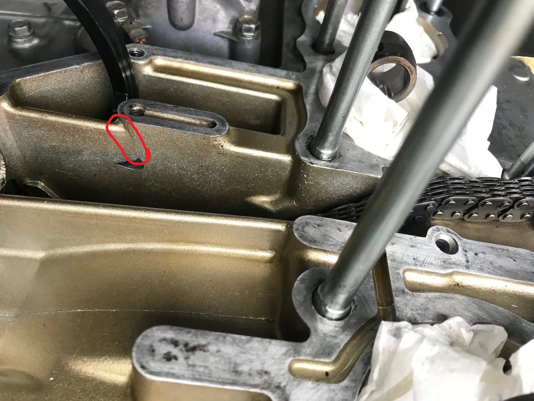

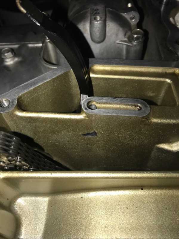

Marks from cam chain idler gear at the crank case

I also have to ask- Do I see a crack in the upper engine case ?

Thanks for your reply, Kawboy. No, I don’t think there are cracks (don’t give me a heart attack) I will take a better look when I get home
