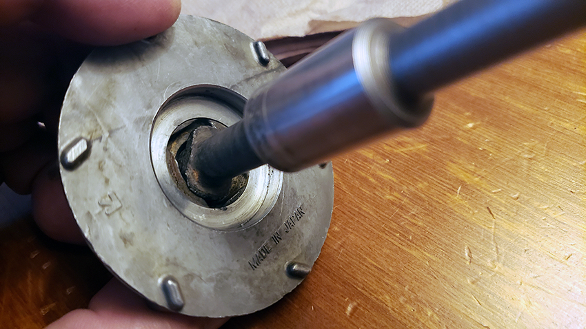

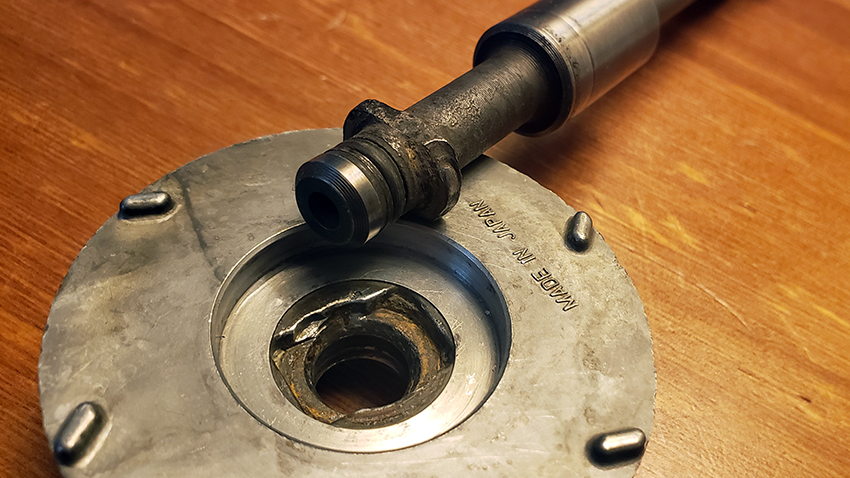

0ther than that - a couple photos to illustrate this! lol
How about starting the engine with open radiator cap? The coolant level should come up - it would mean the pump is spinning. You could also loosen the hose with the cap closed and see if it starts leaking with pressure.

I've had this wear issue. lobes corroded away on shaft and back of impeller worn away. New CNC impeller from Germany and a work colleague welded up the lobes on the shaft and then turned them back to proper dimensions
