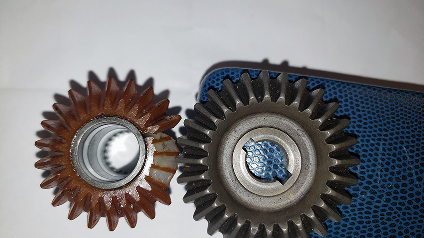

By looking at this one, it was stripped by trying to undue the nut on the water pump shaft while the timing shaft was immobile.

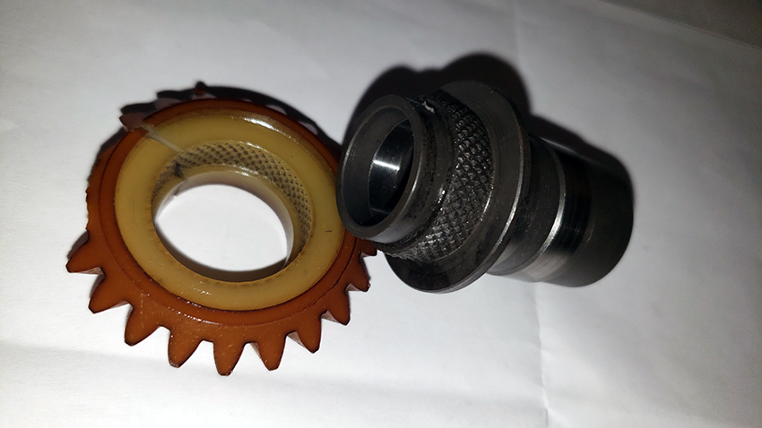

I haven't seen this before, so here is how it looks on the inside. If I remember this correctly, you can send it to the German site and they will install a new nylon gear on it.
