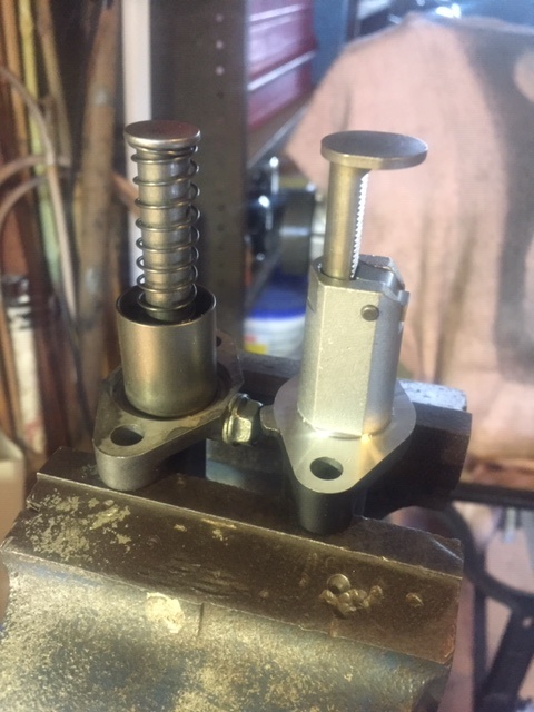

My 1979 basket case still had the original cam chain tensioner and I was advised through the forum to upgrade that. Suggestions in the FAQ on the site pointed me to buy the ZX-11 one (Kawasaki Part # 12048-1113). However, there seemed to be a question about having to shorten the spring for the new one, but no real clarity anywhere that I could find.
The question was: can the new one simply be used or does it need the spring shortening to lessen the tension so it is the same as the old one? The thought being that the new one would put too much tension on the chain and wear out the chain rollers(?).

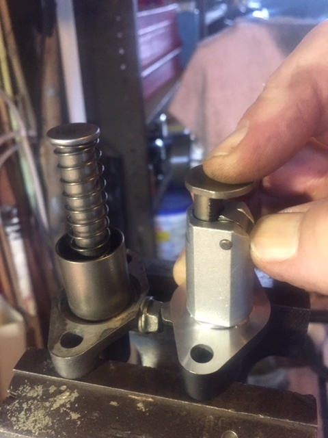

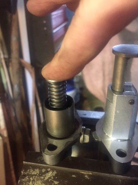

I was thinking of all sorts of clever ways to measure the different tensions, but in the end I simply compared the pressure I needed to used to depress the springs by one finger, and certainly the new one needed a LOT more pressure to depress fully. Therefore the tension will be much more with the new one.
So the questions still stands: Do I need to cut the spring on the new tensioner before I install it? What have other people done?
Pics of my test attached.
Both in the vice:
New one:
Old one:
Both in the vice:
New one:
Old one:
