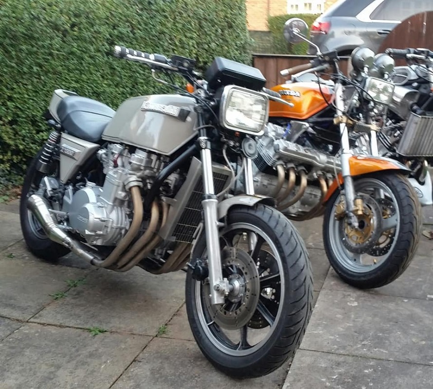

Amazing look. Am I right to say that you can compensate the size of the radiator by the amount of liquid you can push through (basically) ?
The V12/ Z2300 must have roughly the same issues - I learnt he had installed a new cooling-pump ?
Just some thoughts.
Last edit: 7 years 11 months ago by Kawboy.
  • Phil
  • Phil's Avatar
  • 1984 ZG1300-A1 DFI
  • Posts: 460
  • Thanks: 139
Re: Radiator Options
BigSix wrote: Amazing look. Am I right to say that you can compensate the size of the radiator by the amount of liquid you can push through (basically) ?
Just some thoughts.
I do like the way the engine & headers are more exposed B)
On Allen Millyard's V12 he welded another 1/2 of a Z1300 radiator to the original making it 50% larger, he also fitted a higher flow water pump.

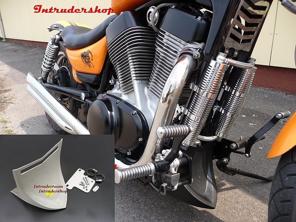

Not sure if this or something similar would make the cut, but I just want to throw it in the mix.

Flowing the water faster has negligible results unless the water was to slow to begin with.
So at idle it may help. On the highway, probably no difference.
