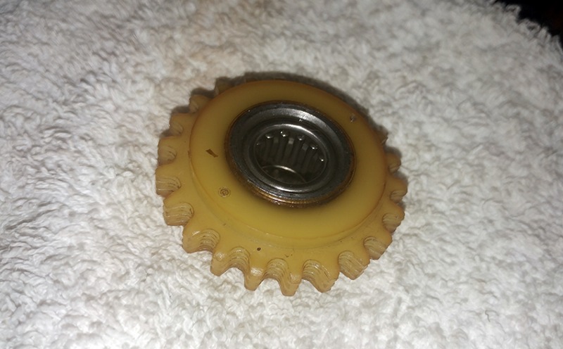

This was mine on the original CCT at 33,000 miles, seems to be a bit worse than Jimichu's? So do I now hold the record?

Hi Phil, look closer at mine, it's worn down to the metal bearing under the plastic, yours is just biting into the plastic base. I'd say I won,

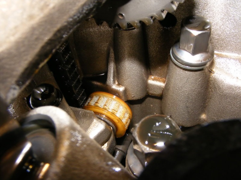

Reflecting I went back and looked at Kawboy's reference photos again and went back to look at my photos again, and went back and looked at my odometer again. Are you still with me?
The Kawboy's second photo shows a new one at 1500 km. I remember asking and panicking about the state of mine, and I was told I am fine.
My odometer shows 8135.6 km (original .5 - yes, I did a 100 meters already spinning the wheel, hahaha), and I have been wondering if my bike really shows the true numbers. Now, comparing, I am thinking again that yes, it's actually very probable!

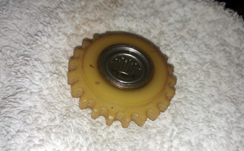

Take a look at my sprocket. I don't think it's too far off from the one at 1.5k. So, I am attaching it to add to the pool of cam chain gears database.

So there's a story here. One tensioner @ 1500 kms showing the same wear as one at 8100 kms. Sounds like the first one had a tight tensioner. Wonder if it was a ZN11 tensioner and if the spring was cut the required 10mm.

There is a discussion on the Z1300.co.uk Facebook page at the moment & the general consensus seems to be that when you cut a spring it actually makes it exert more force
www.eatondetroitspring.com/cutting-coil-springs-calculations/
A fella did some tests & found that the ZZR1100 (ZX-11) CCT with 10mm cut off the spring exerts nearly twice as much force as the spring in the original (K)Z1300 tensioner. I'm going to revert back to the original tensioner & put a longer lock bolt in.
