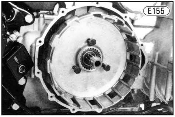

Re: Clutch Play
Ok, I invested in a cordless impact wrench which made the job of removing the clutch nut a breeze. The Clutch basket needed the the three 8mm bolts to remove, right to the last .05mm, therefore it is safe to say there was no wearing of the splines. As my dear old father would say 'tight as a fish's bum!'
