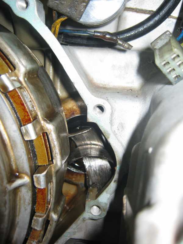

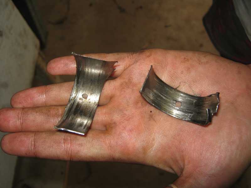

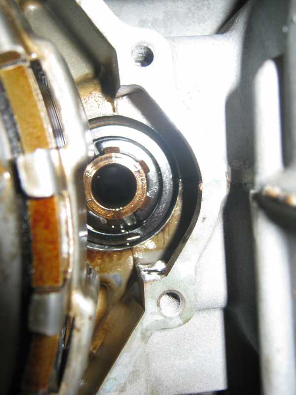

Oh here are photos of the secondary shaft bearing that "failed" on me, just thought i'd show them, cheers
I was wondering what the "tinkling" noise was when the bike was running, the bearings hitting the clutch housing
