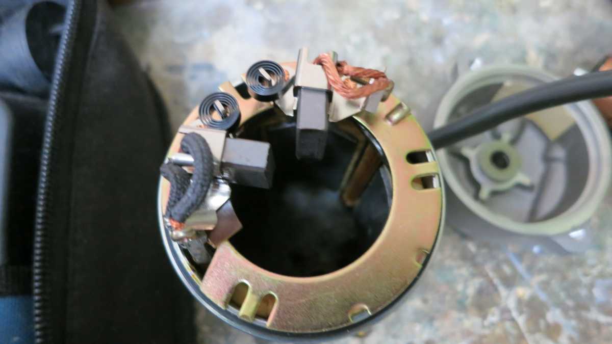

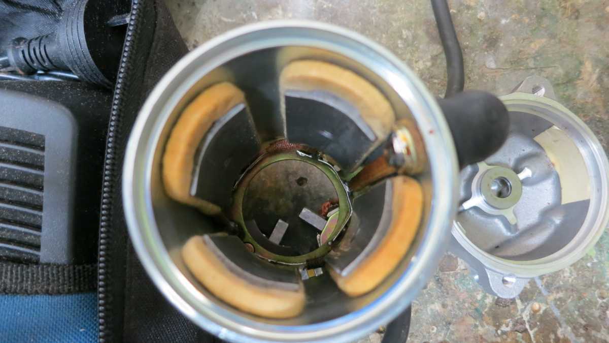

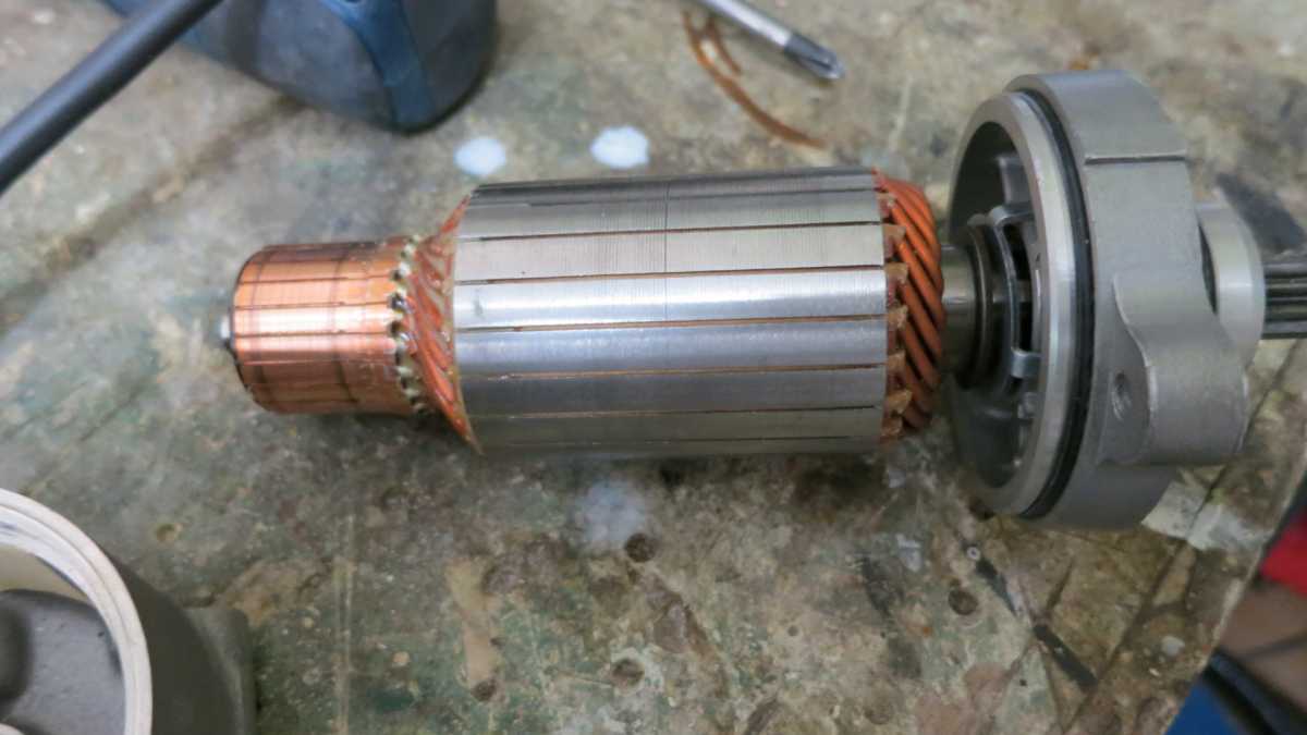

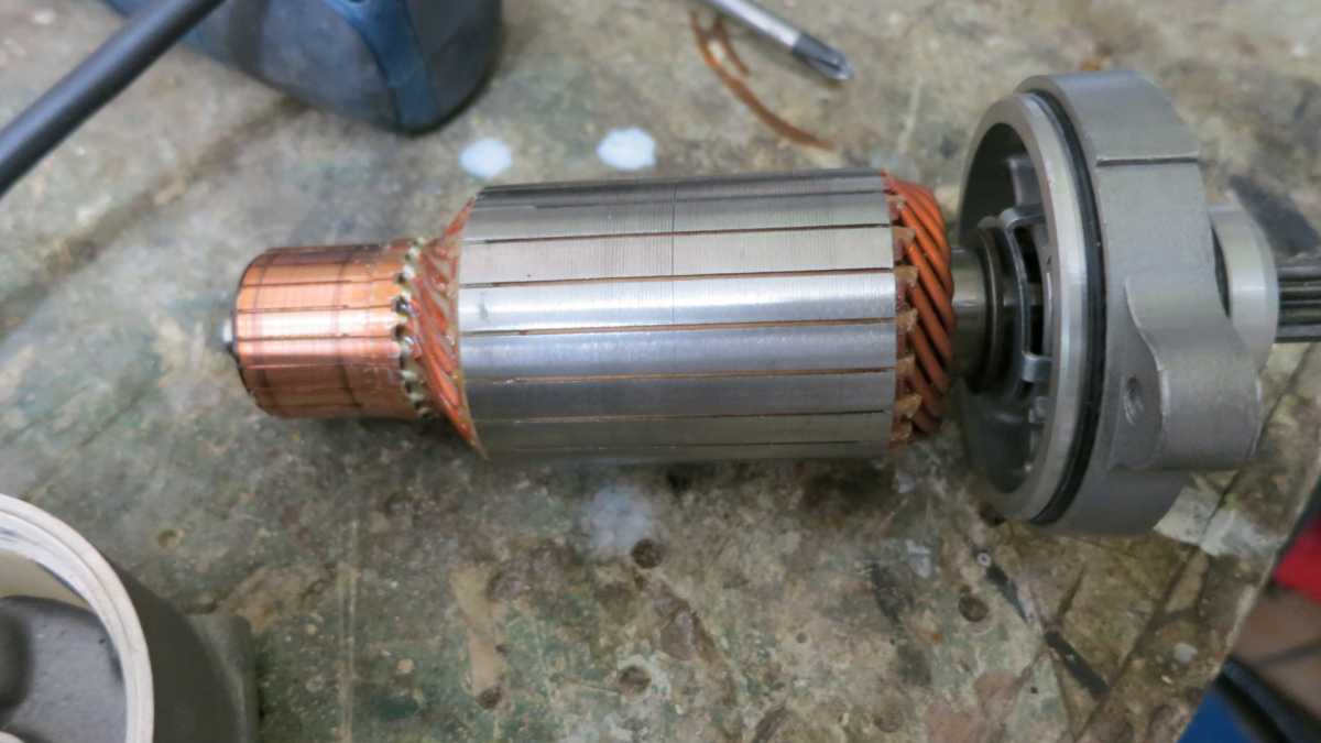

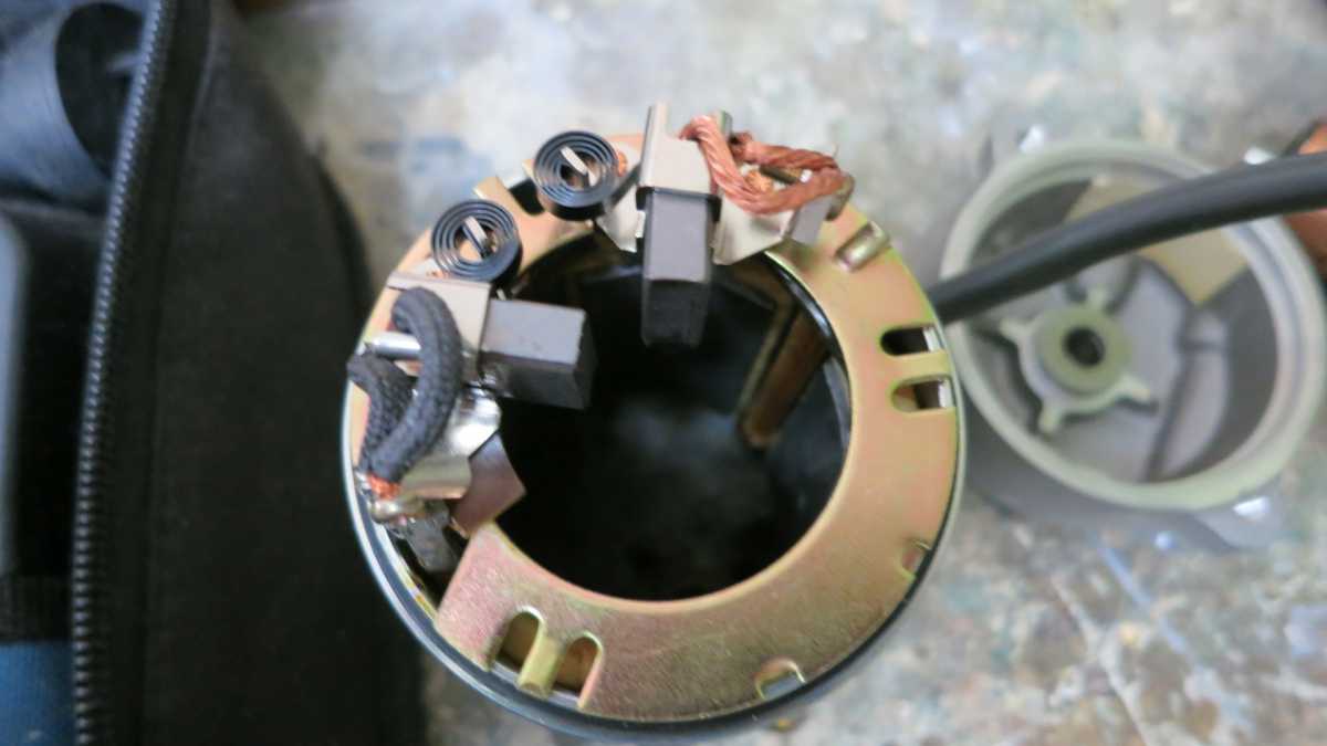

Starter Motor arrived today and it looks pretty good as far as I can tell. I have not installed it yet but here are some photos of the unit.
1983 Z1300 A5 plus Sidecar.
