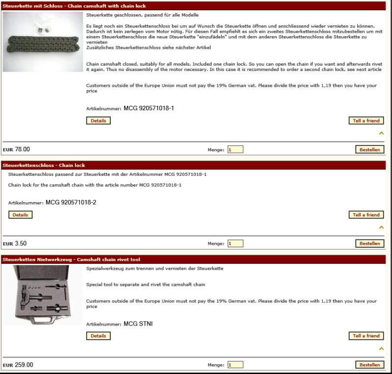

I've often stopped by the German site to look for parts but I've found their prices seem to be high for the most part and a lot of that can be attributed to the Canadian dollar and U.S. dollar difference. So no fault of theirs for that problem.
I would also tend to trust their source for the chain rather than just buy one of off EBay. I've got no idea where "Forseti" chains are made neither the K&L chains.

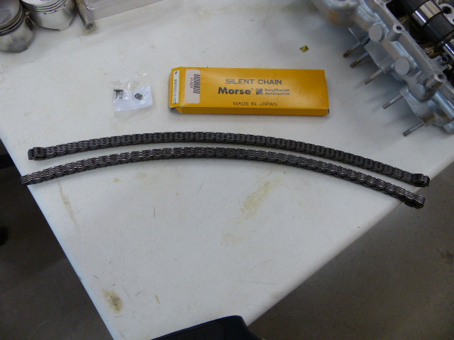

I managed to find a source for the Morse chain and the only way I could buy it was through my local Kawasaki dealer. The supplier was M.C. Distribution and they will only sell through their distributors. For the record the chain is a 82RH2015 -158
This is the chain laying on the table above the chain I removed from the engine. I measured the stretch on the chain and it was within the service limit but the side flex in the chain worried me, so I acquired a new one along with the master link. As you can see in the pic, the new chain has a lot of side flex as well. Must be the design of the chain, so I've learned something here and really didn't need to replace the chain. Still, it's a good exercise for me.

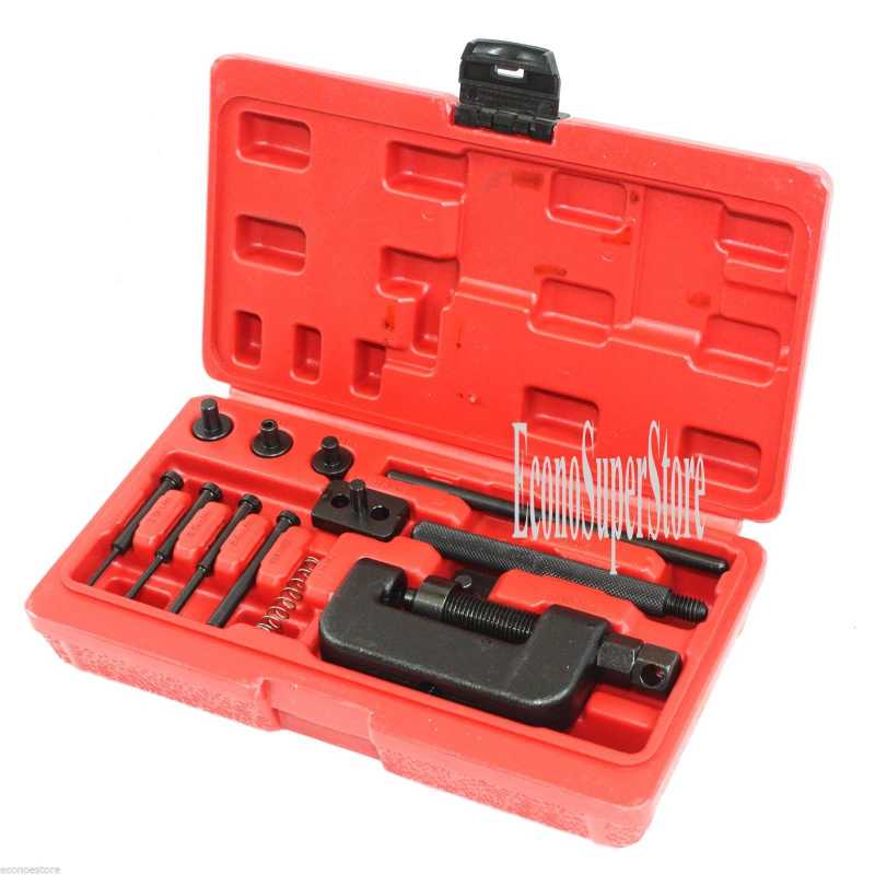

Just waiting for the chain breaker/riveting tool to come in. KZA13 included a pic of a chain tool which would have cost $217 Canadian plus shipping from Germany. This one was an EBay purchase including shipping for $54 Canadian. Should have it in a week.
