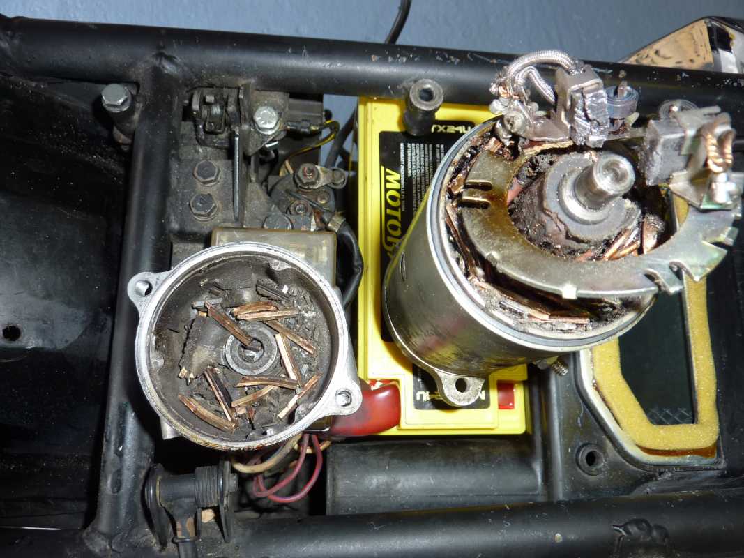

Not sure what model you've got, but on my 1979A1 it was a case of removing the LH side sub-rotor to get to the starter clutch gear wheels and reduction gear.
Just a (horrible) thought, but I was also was getting some very nasty metalic noises which I wrongly assumed was the cogs on the starter clutch gears not meshing correctly: turned out to be my starter motor eating itself.
Might be worth whipping the starter motor cover off and checking it's not the motor imploding ??
Stick with it though, you'll get there.
Cheers Tim
Cheers Tim

11 years 3 months ago
Yikes, that is NASTY!
No, I've not considered that. I was going to hit the starter while the side cover was off and the gears out to see if it was making any noise itself. I didn't consider it may have been the starter itself.
Is it much of an ordeal to get the starter itself out? Do I have to take the stator cover off again?
I'm sorry I'm such an idiot. I'm an electrician because I've never been mechanically inclined. Stripped screws and bolts are my legacy lol
