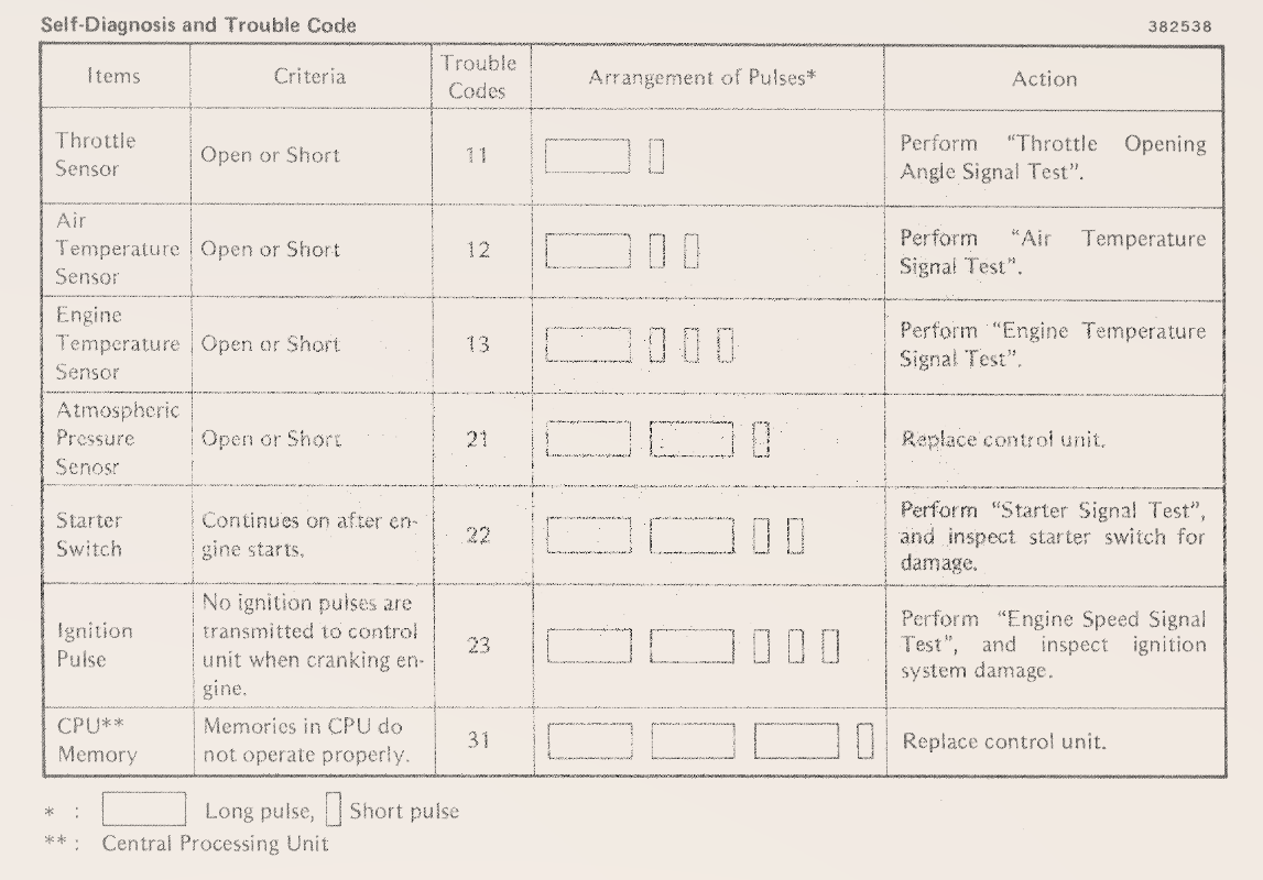

still got the flashing dfi light, one long blink and two short                   back to the zn manual
  • Posts: 3289
  • Thanks: 1222
Re: DFI kill switch is turning my oil light on ?
#32332
Air Temperature Sensor fault. Likely a bad connection.
